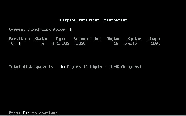

Reply 1 of 10, by Jo22
What does fdisk say ? Is the partition beeing active ?
I'm sorry, that's all that comes to my mind. Well, almost.
Some people have reported that "fdisk /mbr" would have helped them in such situations,
but personally I never saw the need for that. Anyway, maybe you like to give it a try. 😀

Reply 5 of 10, by K1n9_Duk3
Yes, it looks like "fdisk /mbr" fixed it. Now I have at least two systems that can boot from the SD card, proving that it really is bootable. Thanks for your help. 😀
