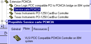

I never used SystemSoft Cardwizard and I don't really know what to do with it ...
Here's the configuration under Windows 95 :
5.16 KiB
759 views
I guess with config.sys I need to load the drivers, so far what I did was
DEVICE=C:\CARDSOFT\SSCIRRUS.EXE
DEVICE=C:\CARDSOFT\CS.EXE
DEVICEHIGH=C:\CARDSOFT\CSALLOC.EXE
DEVICEHIGH=C:\CARDSOFT\CARDID.EXE
I guess SSCIRRUS.EXE is the driver, however I don't know which one to choose as there are 3 manufacturers for cardbus in my computer according to the device manager of windows 95. The actual configuration doesn't seem to work as when I launch "CARDID.EXE", it reports "cannot read the card from library"
I'm completely lost here x)

Reply 7 of 7, by lolo799
The SS***.exe have to be loaded from config.sys, and they should complain when they don't find their chipset...
Cardsoft Socket and Services are quite old relative to Cardbus so it probably doesn't support your chipset, however Cardware 7 does:
http://www.tssc.de/site/products/cardware/cwdw/default.aspx
