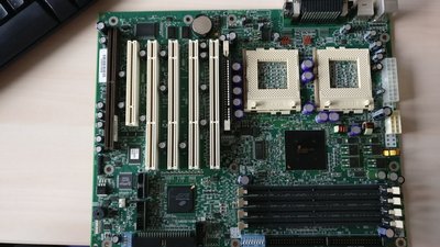

I have trouble identifying this mainboard from a compaq pull. The numbers on the stickers do not yield any viable result on Google. Perhaps somebody recognises this board. If I remember correctly, it came with two 1.26 PIII so it should do Tualatins (although I'm not a 100% sure anymore). The chip seems to be a Serverworks LE-chipset.
The AGP-like slot at the bottom is most intriguing, It has the AGP-colour, an AGP card fits in it, but it is right at the end of the PCI-X and PCI slots. No idea what it is meant for.

Search the board for a Compaq partnumber like 123456-001 and feed this number to the hp partsurfer tool at www.partsurfer.hp.com would be the easiest way.
I don´t recognize the board myself, but it may be something from the low end Proliant ML line, like the ML350 G2. From what I found on the web the ML350 G2 comes closest, so probably its a different revision of the board.
The slot next to the CPU sockets is for a VRM module to feed the second CPU. The Slot looking like AGB is probably something proprietary, AGP slots start at a greater distance from the back of the board and AGPpro extends to the other direction as well.
Reply 2 of 4, by Koltoroc
I can think about 4 possible uses of that brown port. A slot for a "memory riser" to further expand system memory (likely, they have slots that look suspiciously like that), A board to board interconnect for additional CPUs (unlikely, too far from the CPUs) A slot for a PCI riser card (unlikely, never seen riser cards for boards with PCI-X) or a port for a proprietary storage controller ( no idea how likely that is)

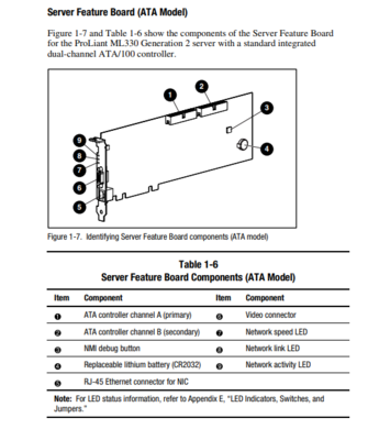

Reply 3 of 4, by flupke11
Thanks all for thinking along. It's apparantly the mainboard of a Proliant ML330 (2nd Generation).
The brown slot is referred to in the manual as "Server Feature Board slot (slot 6)".
This slot provides the SCSI or ATA interface. I've included a page from the manual:
72.75 KiB
274 views
Reply 4 of 4, by eisapc
Right, should have known that. These Compaq servers have the basic features integrated on a single card.
