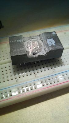

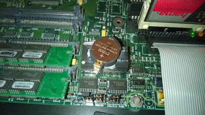

I desoldered the dallas (After extensive training one a dead card) and soldered a socket into the place.
611.37 KiB
324 views
After i added the battery i plugged it in and was disappointed.
813.57 KiB
324 views
I couldn't enter the bios even when the jumper was on clr. After a beer i tryed flashing it with a bios and it WORKS!
Reply 5 of 5, by derSammler
Yes, you should use the last BIOS, version 1.00.16.AX1. Earlier ones have so many bugs preventing you from even entering the BIOS. The last one isn't perfect either, but at least it kind of works.
