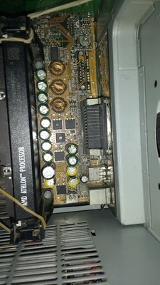

Reply 5 of 16, by TOBOR

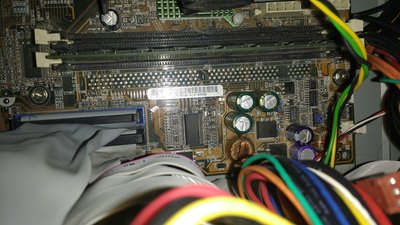

Lots of photos of the motherboard and other hardware would be of some help here. Power supplies from that era are always suspect because of bad caps. 250 watts seems marginal anyway. That PSU could handle PIII ok but Athlon K7 could be too much for it.

Reply 11 of 16, by TOBOR
tomoya97 wrote:
Remember how I said that the PC was stable once it finally booted (Did I?)? Well, I think screwed up my W98 installation, either […]
Remember how I said that the PC was stable once it finally booted (Did I?)? Well, I think screwed up my W98 installation, either that or I damaged another component (Maybe the PSU?), the CPU usage will go up to 100% by just standing on the desktop doing nothing, it will fail to install anything (Damaged installation file) and Afterdark's Flying Toasters screen saver renders at like 2 FPS

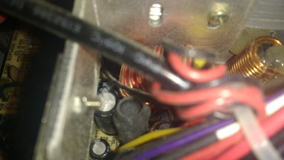

The motherboard caps look good. Open the PSU and show it.

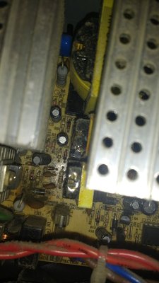

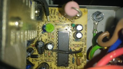

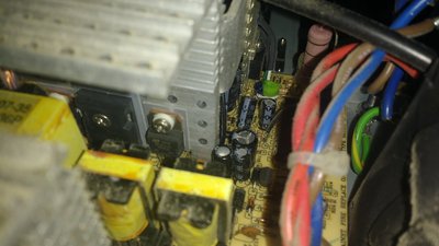

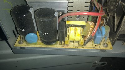

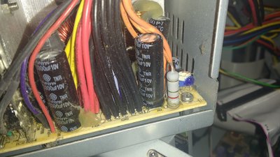

Reply 13 of 16, by tomoya97
307.16 KiB
939 views
124.14 KiB
939 views

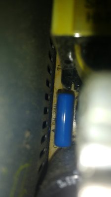

Reply 14 of 16, by elod
Fuhhju caps are bad but they usually vent. Before doing the recap that will surely help that PSU (if it's indeed an FSP) try another one.
Reply 15 of 16, by gdjacobs
It's more common for Fuhjyyu caps to have failed without external indication rather than lasting any length of time.
