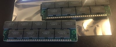

The solution to reduce latency was to create 40ns 30-pin SIMM's, which I have done, thus: -
40ns DRAM... 2 x 25ns clk cycles = 50ns or 2 x 20ns clk cycles = 40ns! 😁
The result... reducing DRAM as a bottleneck, creating a 386 that has lower system latency and faster RAM access.

This is the quick and dirty method yes.
Up until now, whilst sacrificing, learning, testing... and wasting, 1MB is fine.
This method will also work with 4MB SIMM's (as pictured below)... I have enough IC's and will start to convert these also when I am ready.
    166.21 KiB
    2270 views
