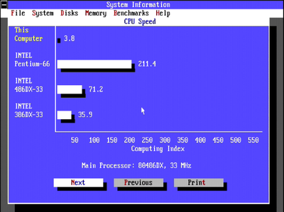

Hey everyone, I recently got a Packard Bell I've been trying to restore and I finally got everything software wise where it needed to be but after booting it up for the first time everything was painfully slow. It took 5 minutes to even get the Windows 3.11 install to boot to idle and everything is laggy including the mouse! I downloaded Norton System Information 8.0 and ran the CPU speed test and well... it doesn't seem right at all. I've attached the benchmark result, which is 3.8.
I'm lost on where to go here... is the CPU dead? Is something screwy in the configuration? Any help would be very greatly appreciated, thanks!

Reply 1 of 21, by Jo22
Well, I'm not sure at the moment. Maybe some sort of throttling function is enabled (any turbo button pins on the mainboard ?)
Did you try to reset the CMOS (BIOS) settings to defaults ?

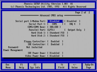

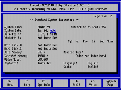

Reply 2 of 21, by narunetto
Yeah, the defaults have been reset a few times. From what I can tell with various diagrams, there's no turbo button but there's a software turbo function, but if I try to use it it beeps as if it's been turned up all the way even after pressing it multiple times. I thought that at first, honestly but nothing really changed.
I attached the BIOS config but there's not really anything there I can see.

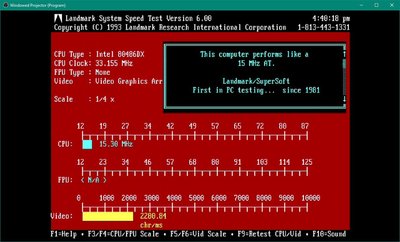

Reply 17 of 21, by narunetto
I got another screenshot from another utility. Says it's running at 15 MHz... cool... it really does seem like a turbo problem but nothing really changes when screwing with turbo options.
