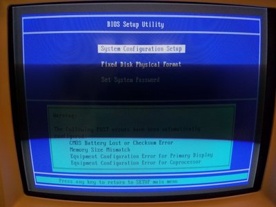

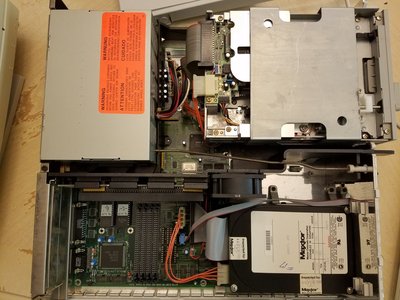

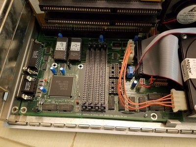

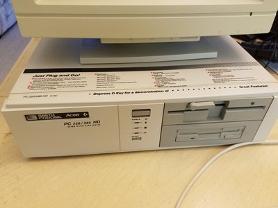

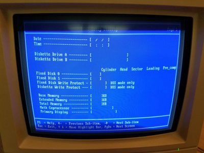

I just bought this excellent condition 286 PC from 1991 but CMOS battery is dead and it will freeze when I enter the "System configuration setup" menu - see all the fields are blank and it freezes on this page.
I seem to be able to skip the CMOS battery error and it then tries to boot from 5.25" drive but I have no such a diskette so I can not verify if it boots.
I tried to disconnect the HDD but it did not help
Anyone knows how what could be the reason? ant ideas how to fix it?

    Freezes on this screen. Note all the fields are blank

Reply 1 of 4, by sf78
I'd start by replacing the battery. I have encountered a few older machines that I was unable to enter setup if the machine saw the battery was dead.
