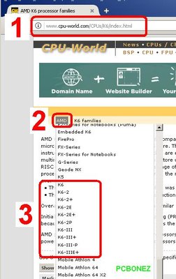

http://www.cpu-world.com/CPUs/K6/TYPE-Desktop%20K6.html (see pic)
50.08 KiB
1326 views
