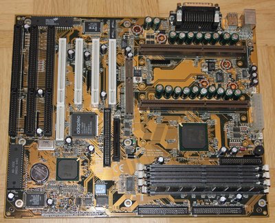

I have played with my Gigabyte GA-686 DLX (Intel 82443LX) board from this thread...

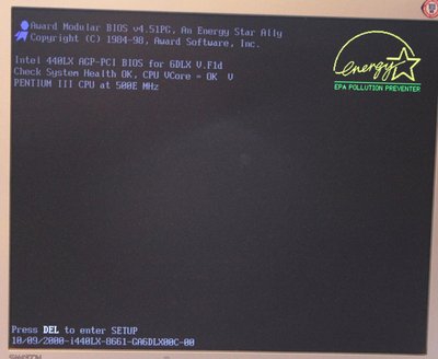

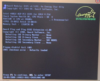

...and tried some Pentium IIIs in it to get a higher speed. They are all detected, but the BIOS stops before the CPU-ID is displayed.
With P2:
602.08 KiB
982 views
With P3:
454.12 KiB
982 views
As I already have the most up to date BIOS revision I assume there is not much I can do to get this running?
But: I have read that the LX chipset doesnt support a P3 at all. But the BIOS detects the CPU correctly.
So what can be the reason it doesnt boot?
Reply 1 of 8, by xjas
I'm running a P3/550 on an Asus P2L97-S, it seems to work fine. (Of course it doesn't support 100MHz FSB so I'm running it at 5.5x75=412.) It was a bit finicky getting it to go (may have just been crusty contacts or something), but after a few tries I got it working & I've been running it ever since. Make sure the CPU runs at a voltage your board can supply.

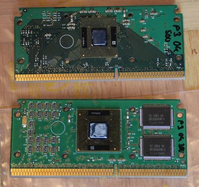

Reply 5 of 8, by Predator99
I have tried these (and identical ones):
The top one boots at 500 MHz ("PB 746509-001").
The bottom one at 300 MHz ("PB 720885-001").
Tried with a cooler installed of course. Should be Katmai, but difficult to find further data.

Reply 6 of 8, by The Serpent Rider
So it actually can boot with Coppermine. Interesting.
