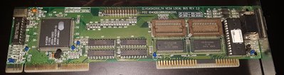

Hi guys,
Just received a Cirrus Logic VLB card, but I'm wondering about the exact type?
Chip is 5429, but reference is CLVGA542XVL/H VESA LOCAL BUS REV 2.0, and FC ID is even worse : KDSCIRRUS5426VL !
- Anyone knows what this card exactly is?
- Any idea of how could I upgrade its memory? (type of modules?)

Reply 1 of 17, by The Serpent Rider
CL-CD5429. 5424-5429 are pin compatible.
Use FPM modules from some S3 Trio card.
Reply 6 of 17, by Eep386
I used to own one of this very card back in the late 90's. It's about as generic a GD5429 card as they come, but it works perfectly with the GD5426 drivers. (I found the WIndows 3.1 GD5429 drivers rather problematic with the card. GD5426 drivers never gave any trouble though.)
Yeah it takes 256Kx16 FPM SOJ RAM. My card had 70ns chips. I don't think those EDO SOJs will work though. 😖

Reply 8 of 17, by Anonymous Coward
I have the same card. My suggestion is don't bothing upgrading to 2MB. It does practically nothing.
Reply 10 of 17, by jimpqfly
So... it's a very strange card...
1. I started my 486 with 2x32MBytes of EDO RAM : during the POST, the video card displayed only half of the caracters from 49Mbytes and above during RAM Check... I solved the issue by placing only 16MBytes of RAM (which is not a big deal with DOS6+Win3.11 anyway).
2. Using HWinfo on DOS, I clearly see that 2048Ko are detected on Video Card RAM. So I guess it's a win 😀
3. I installed the 5429 drivers for Windows 3.11. I used CLMode on the boot to setup my screen at 60Hz at 640x480, 800x600, and 1024x768.
However, in Winmode :
- each time I try to select the 1024x768 resolution, the monitor refresh rate leave me 2 options only : "87 Hz Interleave" (no way for my LCD...), and "Unavailable", so I basically cannot use 1024x768
- with 800x600 I can only choose 16bits colors, and not 32bits. Strange for a 2Mbytes card 😀
Any idea?

It's a QDI card, but I can't find the model name. Not sure if it would be CLVGA5429VL/H

Reply 14 of 17, by blurks
It's my understanding that the DAC is responsible for the availability of color modes and refresh rates, while the graphics chip just generates the image in conjunction with the framebuffer. Adding an extra Megabyte of RAM is only helpful if the DAC can make practical use of it.
Reply 15 of 17, by Anonymous Coward
My opinion is that it was only really designed to be a 1MB card, but the 2MB option was tacked on for marketing reasons.
