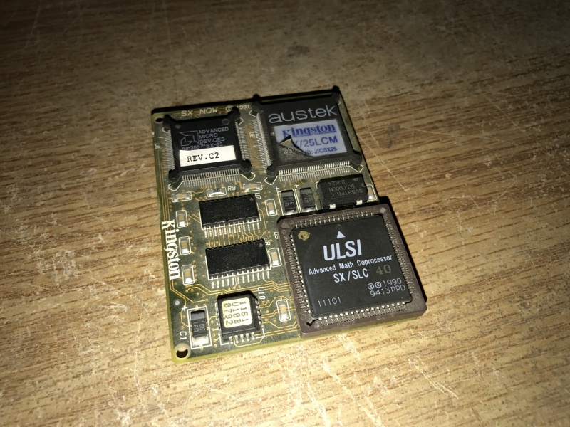

Many of them are designed for specific machines/motherboards, so getting one that fits can be difficult.

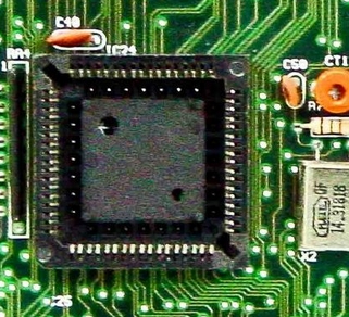

Greetings @mwdmeyer, I just joined up because I am trying to upgrade my 12mhz Hyundai 286 and I think that the SX/25LCM is the only way to do it. Is this something you or anyone here has available? A little about the board. It is a socket like the attached photo. There are no jumpers. The crystal near the chip is 14.xxxmhz (solder blob obscuring most of that). Kingston made a SX/20LCM, SX/25LCM, and SX/33LCM. Am I correct in assuming these were intended to upgrade a 10mhz, 12mhz, and 16mhz respectively? There is an eBayer selling the SX/20LCM but I'm not sure that would work with my 12mhz unit. Can anyone confirm my hypothesis? Is the SX/25LCM indeed what I am to be searching for?
Thanks in advance everyone.
