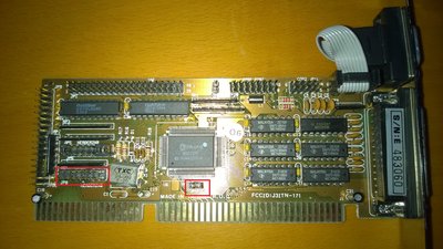

Hi, this is one of my i/o cards.
769.9 KiB
181 views
I diddn't find it on stason so i tried to look at the jumpers myself.
The upper row of 8 jumpers control com, lpt, fdd and hdd.
The lower row and thge single one wouldn't reveal anything.
What tools can i use to find out more if any? I just used msd for now.
Thanks!
Reply 1 of 1, by skitters
It looks like this one
http://stason.org/TULARC/pc/hard-disk-floppy- … IDE-AT-Int.html
Mentioned here
https://retrocomputing.stackexchange.com/ques … controller/6239
