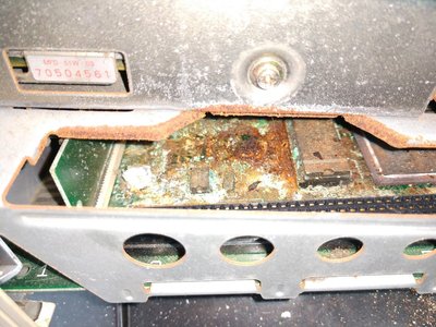

Only paid $10 for it at an estate sale, brought it home, turned on but wouldn't display anything.
I assume there was some huge battery on this sucker that went bad, I can hear somethign rattling around on the inside.

Looks like another victim of a Maxwell bomb... far too common in those computers for the artery backup battery to blow and take out the computer.... and it is almost always a Maxwell branded one.

Reply 5 of 10, by feipoa
If you find spares for cheap, let me know. I need another. Problem with these boards is that the battery leaks everywhere. If not the battery, then those caps leak everywhere. My caps leaked everywhere and ate up the traces.

Based on the damage and the size of the battery, this is reminiscent of pinball board rot. I'd expect there's far more dead motherboards than bad cases. I'll be keeping an eye out but we'll see.

SE/30 boards are expensive and hard to come by without damage, and always must be recapped. However, if you don’t mind the downgrade, you can just put an SE board in the case instead. They are cheap and easy to come by, rarely need recapping (and are not SMD like the SE/30) and they are much more reliable. If the CRT is fine in that case, find a gutted one to use for hacking instead. It would be a shame to junk a functioning CRT.
