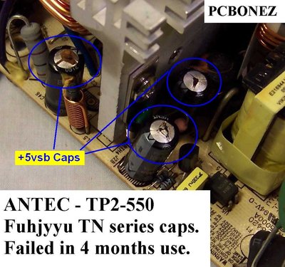

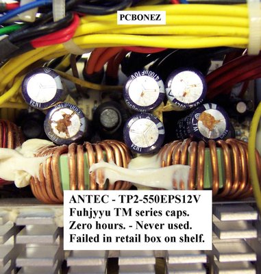

What are yalls thought on this PSU, worth getting?
Will power an XP 2500, 1gb DDR ram, 6800GT
Reply 1 of 19, by PCBONEZ
Don't just pass on it. - RUN! - As fast as you can.
Reply 2 of 19, by PCBONEZ
All the Smart Power I + II, True Power I + II + III, True Blue (and so on) models had the same problem. - Fuhjyyu caps
It was complicated by the fact that some caps were weird sizes that are impossible to find replacements for.
These photos are from some 550w I had.
I've rebuilt about 10+ of them and I've seen 100's of complaints about them online.
I've also seen two cases where Smart Powers caused the owner's house to catch fire.
Never trust PSU review sites. They only see brand new unused PSUs.

Reply 6 of 19, by PCBONEZ
candle_86 wrote:
hmm, so if i open it up and replace the caps i should be fine then
I will say ~probably~ fine if you can find the caps.
(The following uF numbers vary some between models but the situation doesn't.)
(The length is by memory. I didn't write it down. They may have been 45mm long.)
There are usually six 10mm diameter caps that are packed in too tight to up-size the diameter.
= Four are 10x40mm 4700uF 10v. Their ESR is 0.038.
You will not find those. They do not exist short of ordering them custom made.
Best you can do is 3300uF 10mm with appropriate ESR. (Panasonic FK)
= There are two 3300uF 10x40mm 16v. Their ESR is 0.024.
The closest I know of that is still in production is 2200uF 16v 10mm. (Panasonic FK)
I used to get 3300uF 16v 10mm with good enough ESR from a fellow that custom ordered caps.
I would replace all six caps with those.
He no longer orders those and I don't know of an alternate source of new caps.
Sometimes I see NOS Teapo on Ebay ( 3300uF, 16v, 10x40mm, SC series) that will work but that depends on how much you trust Teapo.
I would look for a different PSU.
