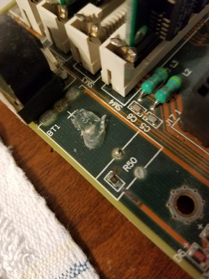

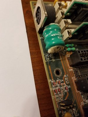

When I first got it home I took it apart and found that the barrel style CMOS battery had begun to leak, so I snipped it off and cleaned the board. So I need to replace that, I have seen some external CMOS batteries that hold a regular lithium battery, is this an acceptable replacement?

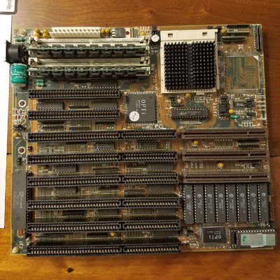

Reply 1 of 19, by quicknick
Here are the settings for your motherboard:
https://web.archive.org/web/20020603034300/ht … ard/mboard.html
Don't use regular (non-rechargeable) batteries in a place where they will get charged. J1 should be the external battery header, you can connect there a pack of 3 or 4 AAA regular alkalines. The external battery doesn't get charged. Scrub the board with vinegar if there is the slightest sign of corrosion, in time it will get worse.
A photo of your board would be welcome.
Reply 2 of 19, by johndutch1987
Thanks for that link, that will be very helpful.
Here is a pic of the board
948.02 KiB
987 views
Then the leaking battery
917.74 KiB
987 views
And after romoval and cleaning
983.5 KiB
987 views

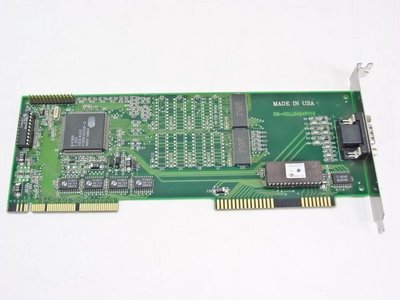

Guess Ill just pick one of those moderately priced cards and go with it, Im not really an audiophile or anything, so ill get one, and upgade later if necessary.
As far as a video card, I found a cirrus logic CL-GD5428 pretty cheap. Saw a few people on here saying it was a decent card. Anyone have an opinion on it, or know much about it?
36.17 KiB
852 views
Reply 17 of 19, by Scali
The CL542x cards are among the fastest VLB cards, and are quite good in terms of compatibility. My 486DX2-66 has a Diamond Speedstar Pro VLB, which is based on a CL542x. Always did a fine job for me.
Reply 18 of 19, by johndutch1987
There is a diamond speedstar pro version i can get as well, about the same price. Is there any difference between the two?
Reply 19 of 19, by Scali
Difficult to say. Those brand-less cards could be great, or could be terrible (I have a real Stealth S3 Trio card, and a brandless card that runs faster). Diamond isn't great, but it's not terrible either.
