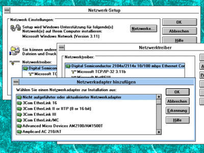

Reply 13 of 81, by Jo22
I like the 3Coms, because they work out-of-box with WfW 3.11..
It can even auto-detect them (among others), which I think is really is cool. ^^
