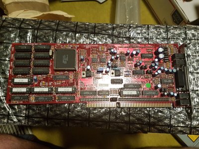

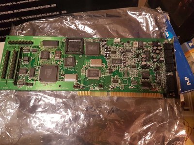

    340.41 KiB
    5200 views
    Sound Blaster AWE32 - CT3780

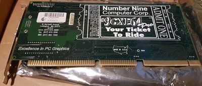

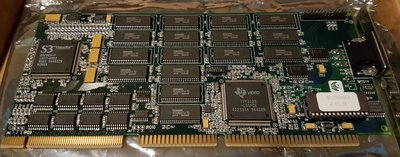

    Number Nine #9GXE64 Pro 4MB VLB Back Ticket to Ride
    2 MiB
    5597 views
    Number Nine #9GXE64 Pro 4MB VLB Front
    1.03 MiB
    5597 views
    Number Nine #9GXE64 Pro 4MB VLB Box

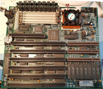

    1.33 MiB
    5597 views
    QDI V4P895P3/SMT V5.0 OPTi 895 82C895

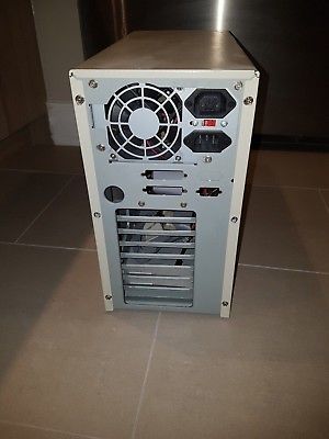

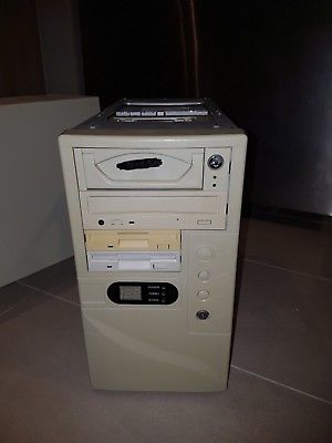

I was able to get an offer accepted on this case! Located in Canada, which is rare and reduces shipping costs for me greatly! $85CAD + $25 shipping. For me, it has everything that I'd like... 2 5.25 bays, 2 3.5 bays, 188 frequency display and obligatory Turbo button. Baby AT reduces the profile compared to those behemoth Full AT cases from out in California.
https://m.ebay.ca/itm/Generic-Baby-AT-Compute … OM/202301405825

Reply 6 of 28, by fitzpatr
I spotted the motherboard in a lot of 3 486 boards for $50. This was the one that I had hoped worked. The layout is great for longer cards due to the CPU being above the slots. Not a problem normally, but I will be using a heatsink for good measure. It's got a Voltage Regulator for 3.3V CPUs, CR2032 battery, and an absolutely insane number of jumpers!
It's mentioned in the RedHill guide, and they have a good opinion of them.
http://www.redhill.net.au/b/b-95.html
My biggest concern at this time is that the GUS will not be functional. I believe that I tested the video card when I got it, but I didn't have an OS, so no way to test the GUS.

The new case arrived yesterday. Very slight damage to the plastic, but mostly imperceptible.
I've taken out my sound cards from storage, and I've attached the pictures to the first post. I am leaning towards a Sound Blaster AWE32 CT3780 right now, but this does not have RAM slots. I don't have any of the "best" AWE32s. Just the CT3780 and CT3670.
I could use the CT2770, Goldfinch, GUS, and MPU-401AT. That and Video and I/O would have me pretty full. An MPEG decoder would max me out.
I did encounter a problem, however. This motherboard, in 2 cases now, will not power on when inside of a case. I observed this behaviour first last year once I received the motherboard. I'm trying to remember if ATX PSUs did not even activate, but I know that the 2 AT PSUs that I tried tonight would start sending power to the CPU fan. As soon as I take the motherboard out, the system will power up and I can get into BIOS.
I've checked the standoffs, so I'm concerned that it could be a cracked trace. It could also be a short to ground. Does anyone have any suggestions?
The good news is that I've confirmed that the Video Card works!

I've got a guess as to what the problem was. There is a mounting hole just below the CPU Socket. My case has a threaded hole for a standoff, while there is no metal ring around this hole on my motherboard. To mitigate, I used a non-metallic washer on the first install. The system would not POST. It still felt like it might interfere with the SMDs directly next to the hole, so when I reinstalled the motherboard into the case, I didn't use any screws. It worked! I then screwed everything in except the aforementioned mounting point, and it is still functional.
My next steps are to locate my I/O Controller, choose a hard drive, and proceed from there.
