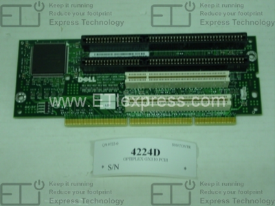

The Optiplex GX110 User Guide states that there exists for the Low Profile desktop model an optional PCI/ISA riser board to replace the PCI riser board that comes with the system.
I have been looking for this riser board for almost a year now and in the process ended up accidentally purchasing a GX1 riser (which does not fit due to a completely different edge connector) but have yet to even see a single photo or find the part code of this mythical piece of hardware.
If anyone has it, can share a photo or part number for it, or even better supply me with one, I would be eternally grateful.

There are a few posts on the Dell Community Forum which suggests the part number is 4224D
Actual pic

Links to the item seem not that uncommon online, though actual stock may be another matter.
If their site is current, the place I found the picture shows 1 refurb in stock ATM (US-based)
