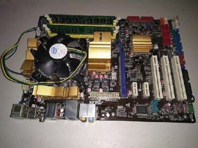

386SX wrote:
Hi, I got a Asus P5N-EM mainboard Socket 775 and Nforce 630i chipset and I'd like to know which are the best processors and your […]
Hi,
I got a Asus P5N-EM mainboard Socket 775 and Nforce 630i chipset and I'd like to know which are the best processors and your opinions on these ones. The Q6600 and Q6200 I already have to try and maybe I could find the Q9650 for an office pc. Are these still "fast" nowdays?
Are there even better cpu for these chipset?
Thank
Bye
I Have the same mobo's the original Asus P5N and the New edition.
I bought one used on eBay and one NEW. One came with Asus graphics cards SLI GT 8800's
Really nice looking cards.
I purchased OCZ Asus SLI ram 6400. 8gb kits for both mobo's
I have not put them together yet but when I do they should look very nice and run good.
one came with an Intel Q6600 however I think I will get some Q9650 for each mobo.
Should preform okay Geekbench CPU score about 5,500 and they support Windows 2000 and XP.
    36.85 KiB
    1478 views
