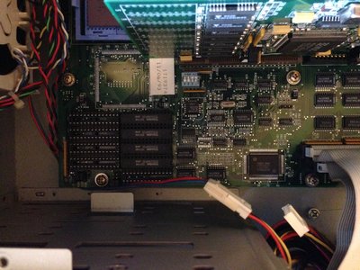

Hello, I have a Gateway 2000 486dx 33 desktop computer that I would like to get back up and running.
I recycled my old 486 computers from 1993 and I wish I had kept them. So I purchased some used 486 motherboards however had had no luck trying to get them working. I recently purchased 2 of these Gatewway 2000 486 computers thinking they would be easy to setup however they are a pain.
The old phoenix bios version 0.10 has limitations and difficulties trying to setup.
Bios problems:
1) Hard drive limitations of 1600mb. sectors and cylinders.
I tried some old IBM smart IDE Deskstar 12gb drives with a 2gb clip but they would not work with this bios.
I tried some IDE to Compact flash adapters with 20gb SD but they would not work with this bios.
I have some old Connor drive 512mb which does work with this bios.
I tried an old Seagate 528mb drive which I could not get to work.
So I was able to get 2 drive to work ( Connor 512mb )
2) Second problem is that I can NOT get the computer to boot off of the combo floppy drive. It is 1 floppy connection to a combo floppy drive ( 3.5 and 5.25 )
I had DOS preloaded on the Connor hard-drive and was able to boot to DOS. I was able to access the 3.5" floppy drive and read the floppy disk okay.
So I know that 3.5" floppy disk works. The problem is that I an unable to boot from the floppy at startup. The bios initializes both floppy drives and then exits to the hard-drive. There is no drive seek preferences in the bios. Unfortunately I formatted the Conner hard-drive and now have no way to boot off the hard-drive. If I press to seek drive again the bios tries to seek from the 5.25 floppy. Unfortunately I do not have any DOS boot disk on 5.25 floppy to check to see if the 5.25 floppy drive is working correctly.
I did disassemble the combo floppy drive and clean it of dust and debree and cleaned the heads with isopropyl alcohol and the drive appears to be working correctly.

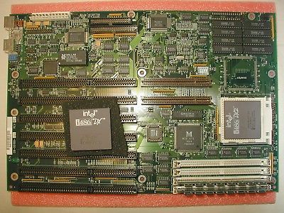

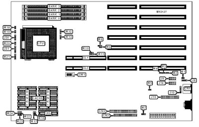

Also I need to add a CDROM drive. The motherboard is an "Micronics JX30G"
http://stason.org/TULARC/pc/motherboards/M/MI … 30G-VL-BUS.html
http://webpages.charter.net/dperr/micronics/900189.htm

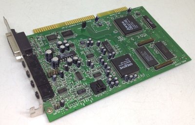

I want to add a CDROM but I only have 1 IDE controller onboard. I purchased a Creative Labs CT1879 IDE controller card ISA.
which I hope will work with this computer.
I also have a Diamond ISA sound card with a build in CDROM controller that I could use.

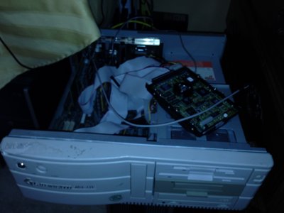

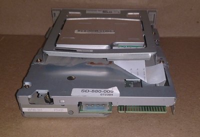

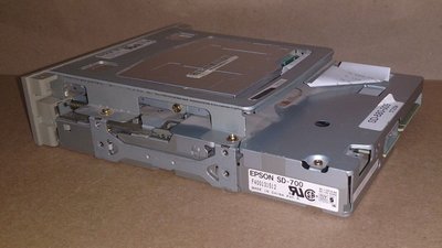

Reply 1 of 22, by Intel486dx33
Update:

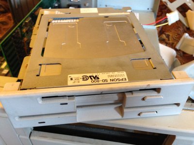

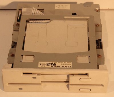

I have two of these computers. I was able to get one of then to work and boot off the 3.5" floppy okay.
So it turns out that one of my combo floppy drives is not working. It could not read the 3.5" floppy.
Anyone have any suggestions on how to fix this ?
I did clean the heads with isopropyl alcohol however drive is still unable to read disks. Its a proprietary combo drive.
I believe it is by TEAC.inc

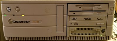

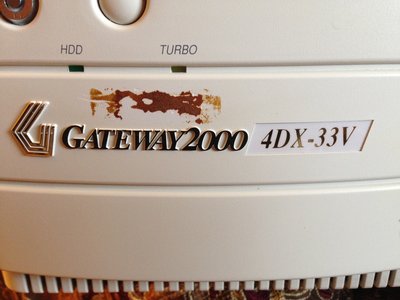

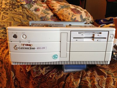

Reply 2 of 22, by Intel486dx33
The computer and floppy drive looks like this:
    161.87 KiB
    2801 views
    gateway 2000

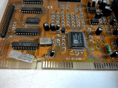

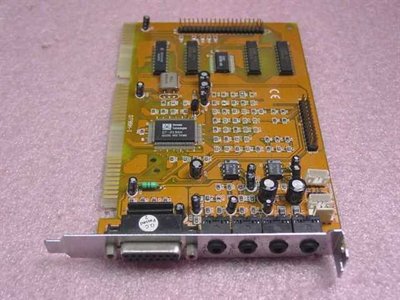

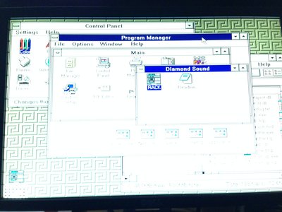

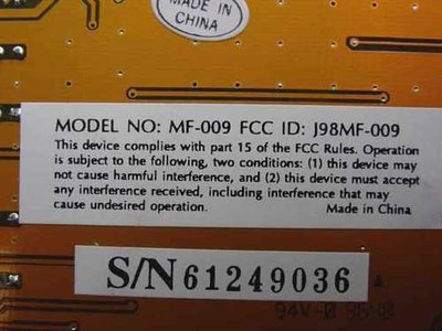

Reply 3 of 22, by Intel486dx33

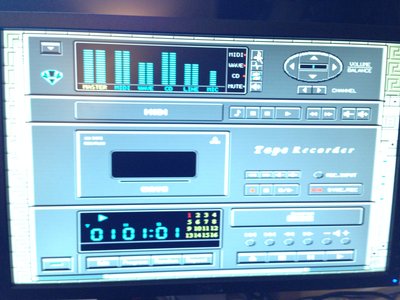

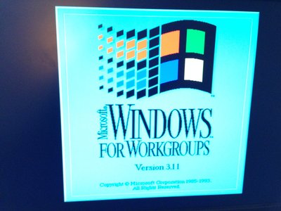

Update:

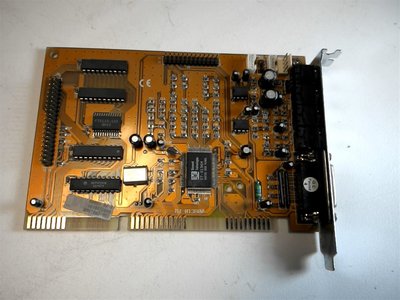

I was able to get one of my Gateway 2000 computers working. I used the Diamond sound card with CDROM interface to get the CDROM working.
However I could not get this card to work with WinNT351. I need the CDROM driver for this card so I can install WinNT351.
Does anyone know what and where I can get a WinNT351 cdrom driver for this Diamond sound card?
What driver file can I use to get the CDROM to work during the install of WinNT351 ?

RACK for Diamond Sound System:
1. Structure and components:
The RACK consists of a MIXER control panel, MIDI panel, WAVE panel,
and CD panel.
1.1 To enable or disable a panel:
Clicking the mouse button on the MIDI, WAVE, or CD in MIXER control panel
will cause the corresponding panel to disappear, another click will cause the
corresponding panel to re-appear.
1.2 To change a channel:
Click channel LEFT or RIGHT button to change to the channel you want.
1.3 To activate volume and balance control:
Change to the channel you want (see 1.2), then click up or down arrow buttons
to change the volume, or click balance LEFT or RIGHT arrow buttons to change balance.
1.4 To mute system:
Change to the channel you want, then click MUTE check mark to disable sound,
click again to re-enable sound.
2. MIDI panel
2.1 To open or close a MIDI file:
Click the button of the MIDI sign on the MIDI panel, choose OPEN to open a
MIDI file, or choose CLOSE to close a file.
2.2 Auto repeat and show information:
Click the button of the MIDI sign on MIDI panel. Clicking on AUTO REPEAT or
SHOW INFORMATION will enable or disable the selection. When AUTO REPEAT is
selected, the MIDI file will be played again when it reaches the end.
When SHOW INFORMATION is selected, the MIDI window will open and the
information from the MIDI file will appear on the MIDI window. When a MIDI
file is opened, you can also click the MIDI window to show the information of
that file.
2.3 Other operations:
When a MIDI file is opened, you can click PLAY to play it, or click PAUSE,
STOP, FF or RW to manipulate the selection. You can also use the volume control
buttons on the MIDI panel to control the volume directly.
3. WAVE panel
3.1 Select TAPE I or TAPE II to playback:
There are two TAPE boxes on the WAVE panel. TAPE I can only play wave
files. TAPE II can play and record wave files. There is one set of
control buttons on the right of WAVE panel. When Tape I is selected,
the control buttons will take effect for TAPE I. When Tape II is selected,
the control buttons will work for TAPE II. Click the button
TAPEI/TAPEII to select between TAPEI or TAPEII, or push the button TAPEI
PLAYBACK on TAPE I box to select TAPE I, while pushing the button TAPEII REC/PLAY
on TAPE II box to select TAPEII. It can not be play wave and record wave
simultaneously.
Note: When you want to playback a wave file, you need to select TAPE I/TAPE II first.
3.2 Open a wave file to play:
Push the OPEN button, select OPEN on the menu, select a wave
file to play. When the wave file is opened, the TAPE containing the
file is automatically selected, just push the PLAY button to play it.
3.3 Record a wave file:
Push the button REC.INPUT to select the input media (Line in, MIDI,
Audio CD, or MIC), then push the the button OPEN on TAPE II and select NEW
to create a new wave file. The TAPEII indicator will be red to show it
is waiting to record. Play the source media, and push recording button on TAPEII
to begin recording. When finished recording, push the record button (now it is a
red square) to stop. After finished, save the file as the name you specified.
3.4 Synchronous recording (record and play simultaneously):
After selecting an INPUT media and new wave file for recording, push button
SYNC.REC to begin a synchronous recording. The mixer will automatically
play the source file and begin recording at the same time.
4. CD
4.1 EDIT and Program:
Push EDIT to select which tracks (selections on the CD) to play
and add it to the Playlist. Then click the Program button to play the selected tracks.
4.2 Random play:
The Random button plays tracks in a random order.
4.3 Repeat:
To repeat one track of a CD, select the track and push the repeat button one time.
A single repeat signal will appear in the CD player window.
To repeat the full CD, push the repeat button 2 times.
A full repeat signal will appear in the CD player window.
Reply 4 of 22, by Intel486dx33
I bought these back around 1995 and had them lying around.
I was able to get these to work with Win_311 and DOS 6.22
Diamond Sound Card ISA MF-009

Reply 6 of 22, by Intel486dx33
Yes, I am just using this card right now for the cdrom controller.
I plan on using the Sound blaster Vibra 16 ISA which is not that great but may be a little better in sound quality.
The problem is I only have ISA and VLB slots for cards.
If I can find an Sound Blaster AWE32 or AWE64 ISA card then I will get it. Hard to find.
This Diamond card does not sound that bad. It is Sound Blaster 16 compatible.
It sounds okay with my Klipsch Pro media 2,1 speakers.

Reply 8 of 22, by Intel486dx33
I also have some Intel 486dx2-50 and dx4-100 CPU that I was planning to use in a 486 build however I can not find an good socket-3 motherboard.
So I might just put these in these Gateway's. What do you think? Keep it original or Max it out ?
I also have some L2 cache saved up from 1993. I can max it out to 512kb of L2 cache. currently only has 128kb.
The mobo supports up to 64mb EDO ram. ( 4x16mb ). that is good for Win 3x, NT351, or Win95.
Reply 9 of 22, by PC Hoarder Patrol
I have a similar problem with my TEAC floppy combo (FD-505-000), with the 3.5" not working even after head cleaning (may be a head alignment problem but that's much harder to solve). It seems you can replace the floppy drive separately IF you can track down the correct TEAC model number. Problem for me is that the one I need seems to have been used mainly in Tektronix oscilloscopes and medical equipment.
The combo drive in your picture looks more like the TEAC FD-S05 -lxx -2xx -3xx (different eject mechanism to mine) so the replacement 3.5" will have a different model number.

Reply 11 of 22, by Intel486dx33
It's and Epson SD-800/700 floppy drive.
The 3.5" drive is NOT working correctly. Heads need repair or cleaning. Unable to read disk.

Reply 13 of 22, by Intel486dx33
Work in progress Photos:

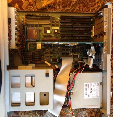

Reply 14 of 22, by Intel486dx33
More photos

Reply 16 of 22, by Intel486dx33
Here are the drivers for this Diamond sound chip card.
Works with DOS/3x/NT/95/98
I did not see the drivers in the library list.
    Diamond_MF009.zip
    691.14 KiB
    47 downloads

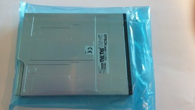

Reply 18 of 22, by Intel486dx33
Update:
The Creative labs cdrom controllers will not work in this build as I want to use WinNT351 and there are NO drivers for this card.
Only Win95/98 drivers.
I was able to find an NEW Epson floppy for this combo floppy drive setup.
it's actually a "EPSON SMD-1100 1.44 MB, 3.5" FLOPPY DISK DRIVE"
I was able to find a NEW one for only $6 plus shipping. $3.75
So now I can fix my combo floppy drive setup.
