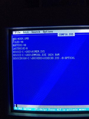

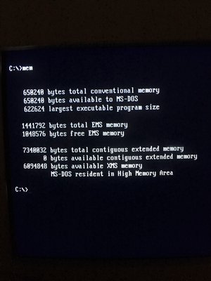

Reply 12 of 18, by fsmith2003
derSammler wrote:
Show us your config.sys and the actual output of mem.
737.79 KiB
1815 views
Config.sys
570.01 KiB
1815 views
MEM

Reply 14 of 18, by derSammler
That MEM outputs looks fine to me. The sum of free lower memory, XMS, and EMS adds up to almost 8 mb, which is how much memory you have.
That line saying "0 bytes available contiguous extended memory" seems to be normal. If you google for screenshots, you'll find that even the DOS box in Windows XP shows that:
DOS-commands-010.jpg?w=620&q=55&auto=format&usm=12&fit=max&s=e660b13456e49eb12be1e3df6e7d700c
I guess you don't have contiguous extended memory unless the CPU is running in 386 protected mode.

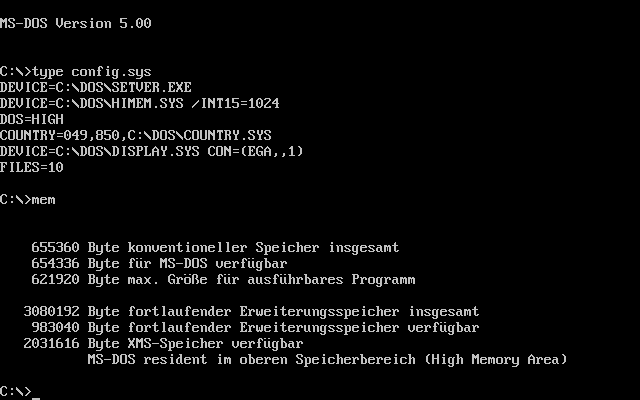

Reply 18 of 18, by Jo22
derSammler wrote:
That MEM outputs looks fine to me. [..]
I belive you're right. The zero amount of memory could be related to the old INT15h interface.
If I tell Himem.sys to reserve 1024KiB of Extendend Memory (not XMS) it will show a number.
