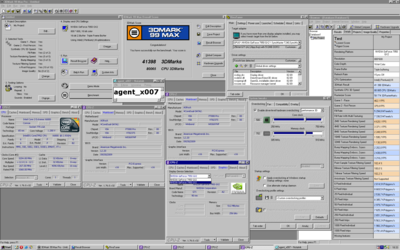

Reply 3 of 4, by agent_x007
If your driver has control panel, you can disable Vsync from there.
You can also use RivaTuner to force disable Vsync.
