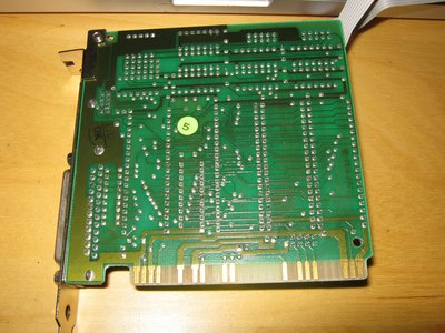

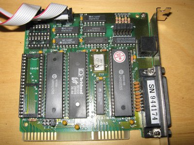

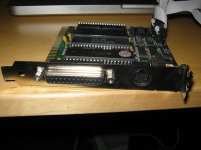

I picked up this 8-bit ISA card in a recent fleamarket find:
134.19 KiB
3731 views
Sure has a PS/2 mouse connector, it's even indicated as such on the board itself. Although since the other connectors are serial and parallel ports it may just integrate a PS/2 to serial port bridge...

Please take some better photos of the front and back of the card. This card couldn't possibly be fully PS/2 compatible, because 8-bit card edges don't have IRQ12. Perhaps it uses its own special driver.
Reply 5 of 28, by feipoa
Well that little 8-bit ISA card sure looks interesting. I wonder if it was meant for some OEM's computer system. Could you provide some high resolution photos of the top/bottom/side? For PS/2 expansion cards, I've only ever seen an 8-bit ISA Microsoft bus mouse card and a PCI USB to PS/2 card.
All the PS/2 mouse implementations I've seen on motherboards have been on IRQ 12. I suppose it would be possible to run the mouse on a lower IRQ, e.g. IRQ 7, if the BIOS was aware of it or there was some driver to set this up.
Have you tested this card yet?

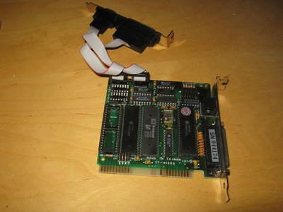

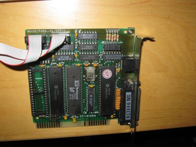

I will upload better pictures tomorrow. The only identifier on the card is a type number "CT-8120S", which gives very few hits on Google (here's the same type of card on a Swiss site: https://www.tutti.ch/de/vi/graubuenden/comput … -8120s/18549739).
AFAIK, the card may originate from the large German electronics mail order company Conrad Electronic, who sold many similar no-name cards back in the mid- to late 1990s.

Better pictures:
115.48 KiB
3608 views
253.98 KiB
3608 views
167.63 KiB
3608 views
211.73 KiB
3608 views
Unfortunately I don't have a system to test the card on (yet).
Edit: After some googling, I wonder whether this card might be an industrial appliance card for driving a CNC router system - notice how the serial ports are marked as "COM X" and "COM Y"? I can't find much info about the "Twinhead" chip, but there's a company called AXYZ that makes a 6010 twin head router...coincidence? The serial ports would then be used to drive the X/Y position of the router head, the parallel port would handle the remaining communication, and the mouse port would handle input from the user...

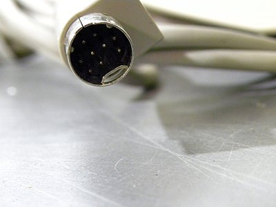

Reply 13 of 28, by BeginnerGuy
That doesn't look at all like a ps/2 port to me. Or is it on the ribbon cables?? The connector I'm seeing is 9 pin.
Ps/2 has 6 pins in a circular pattern with a large rectangular piece of plastic in the center.
Reply 14 of 28, by yawetaG
Yeah, you're right 😅 I didn't look at the connector closely enough. The ribbon cables are 2x serial ports.
Reply 17 of 28, by yawetaG
Oh, well, that too. 😊 Now where to find a Microsoft bus mouse...
(Twinhead apparently was a PC manufacturer in the late 1980s and early 1990s, so maybe the card comes from one of their systems)
Reply 18 of 28, by BeginnerGuy
There are plenty of them on Ebay for me (US). feipoa is right, it's for the MS bus mouse.
(snagged from an ebay auction).
275.57 KiB
3590 views
Not quite PS/2 though 🙁..
