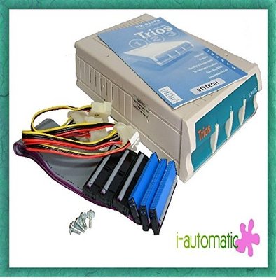

Reply 7 of 7, by Vipersan
Hard to find these days ...
less so in the US ...
I had to import mine ..but opens up a world of possibilities with switched operating systems for old IDE drives.
I use mine in a 6 x OS tower ..which has 3 operating systems per drive (triple primary partitions)
and I can physically select which drive of the 3 prior to power up ..
I then use a boot manager to select the required OS on the drive selected..
I think one is currently being adverised for sale on Amazon..around 25 dollars used.
the :- ROMTEC RX-910T6 Romtec Trios
fits in a vacant 5.25 inch tower or dektop bay.
rgds
VS
