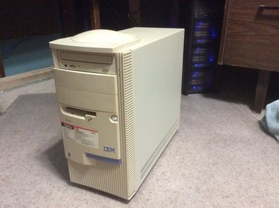

Found one, had to pay a bit more than I liked for it but whatever. These machines are really cool. Also, if you ship out desktops DO NOT pack them in broken pieces of styrofoam. It got everywhere inside the machine and the power supply.
A lovely machine restored to good health.
IBM Aptiva 2176-C73
Intel Pentium 200MHz
64MB 72-pin SIMM RAM (was 16MB)
256K cache via COAST module
3.5" floppy drive
8X Hitachi CDR-7930 5.25" CD-ROM drive
3.5" IBM DAQA-32700 2.5GB 5400RPM hard drive
MS-DOS 6.22 + Windows for Workgroups 3.11
2MB ATI Mach64 GT onboard video
4MB Matrox Mystique 220 PCI video card
YAMAHA YMF-719 OPL3 ISA sound card (replaced an IBM Mwave modem/sound card combo, gross)
Kingston NE2000 clone ISA network card
Replaced internal fan with a larger, quieter one
Not complete yet, just want to add another hard drive for Windows 95.
Some areas were yellowed more than others, like the floppy drive bezel.
After a retrobright, good as new!

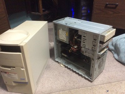

the rear
naked
the guts
More guts... this setup makes it annoyingly difficult to clean.

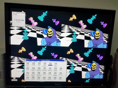

The past is ALIVE!

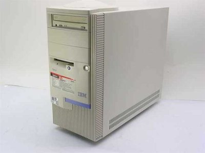

I did purchase a NEWER Aptiva however.
With an AMD K6 333mhz CPU which I replaced with a Pentium 233mhz CPU.
The motherboard has jumpers to select which type of CPU to Choose.

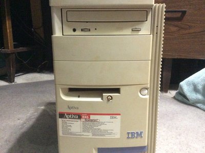

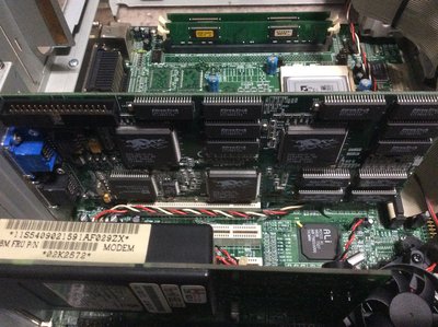

I can chime in on this one. Went out looking for an old ATX case for my Pentium 1, Socket 7, Windows 95 build and ended up being given an entire working PC.
The attachment IMG_0052[1].JPG is no longer available

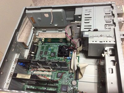

Inside the chassis:
The attachment IMG_0056[1].JPG is no longer available

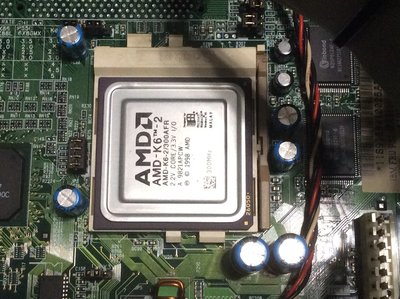

AMD K6-2 300MHz installed and working:
The attachment IMG_0057[1].JPG is no longer available

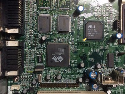

Motherboard has built-in ATI graphics:
The attachment IMG_0060[1].JPG is no longer available
But I just HAD to include this beast in the system...
The attachment IMG_0059[1].JPG is no longer available
Windows 98 First Edition, reinstalled on the hard drive just underneath the CD-ROM drive (which still works, by the way).
System specs:
IBM Aptiva 85
AMD K6-2 @300 MHz
64MB PC-66 SDRAM
ATI 3D Rage II+DVD 2MB
Diamond Monster 3D II 8MB PCI
Crystal Audio sound chip
6GB Quantum Bigfoot 5.25" HDD

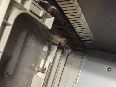

I'd also like to add that the case itself wasn't in the best shape. The Power Button didn't reach the ACTUAL power button inside and there was no way to eject a floppy without a screwdriver, so I made a few case alterations.
The attachment IMG_0054[1].JPG is no longer available
I used a piece of cork and a round-topped phillips machine screw that JUST BARELY screwed into the plastic nub sticking out of the white power button, so now - when the case is fully assembled - that screw hovers just on top of the actual power button, meaning if you push the white button, it'll actually push the inside red power button properly and I can now turn the computer on and off without having to pull the case half-apart.
For the floppy ejector, it turns out the metal leaf spring was there, but the plastic ejector button was missing. There were two holes, though, so I got a 1/4" wooden dowel rod from Hobby Lobby, cut the end to fit, drilled a very small hole at the back side, and used a paper-clip to run through that hole and through the holes on the leaf spring. Then I bent both ends to hold it in place and trimmed to fit. Works like a charm as an eject button now, though I really should paint it blue to match the rest of the case's front design.
This is how the front looks now:
The attachment IMG_0053[1].JPG is no longer available
Yes, when a floppy is present, that wooden button does stick out enough to use easily. And I sanded the end a bit in order to prevent splinters in the future. The floppy drive works just fine.
