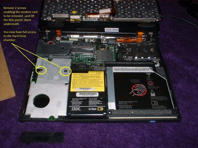

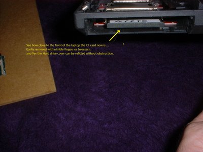

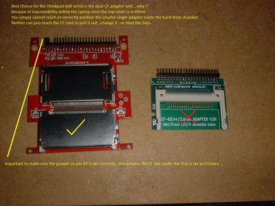

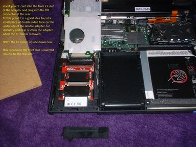

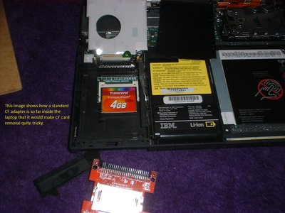

So ..you have Thinkpad 600 /E /X ...and just want to install the OS on a CF ..
On this one it is real tricky ..even if you have the bare bones caddy.
Trial and error ...and I came to the conclusion ...one of those double adapters from Ebay is the way to go.
I suspect you could use both CF slots ..IF the CD Drive was removed ..though I have not tried this.
I think if both CF card B and CD drive were in at the same time there would be a conflict on the IDE bus.
So ..I created some edited photos with text to show how and why the dual adapter is best for this job.
rgds
VS

Reply 1 of 2, by Thermalwrong
Thanks for the pictures, I might try that with my 600X at some point 😀
I suspect that the IDE bus configuration should work with the Dual CF card when both slots are populated, I always thought that the CD drive on these was on the secondary IDE?
Reply 2 of 2, by Vipersan
You might well be correct TW..regarding the IDE bus ..
As I said ..not tried this as yet ..
you might beat me to it
