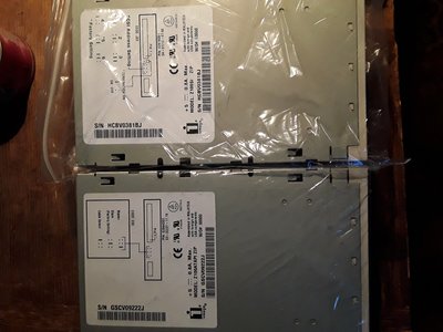

This is my Zip-100 drives, both had seen many poor-readable disks with endless "clicks" (when I was forced to turn off power to eject the disk) and have not dead. But none of them have been used with mechanically broken disks. The ATAPI one even used to repair one dead disk - I found that ZIPs with bad tracks (even with bad track 0) can be repaired by low level HDD utilities like "Victoria 4.47" just like HDDs. And after successful track 0 repair the disk was successfully formatted using "Trouble In Paradise", and now it is a normal ZIP-100 disk which I am using for data transfer between PCs and Macintosh. The SCSI ZIP is working with Mac IIsi (OS 7.1) even without any additional drivers (except FAT16 support extension).
