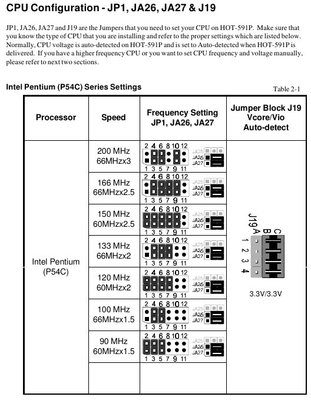

Since I found a cheap shuttle mvp3 591p board would it be worth it to run my 166 @ 100x1.5 or 100x2 (if 200mhz is stable), or should I stick to 66mhz fsb. Note this is a p54c not an mmx.

Reply 3 of 8, by skitters
The manual for the 591p that I found at
http://www.elhvb.com/supportbios.info/Archive … 591p/index.html
doesn't mention using 100mhz for a p54c.
It says to use 66mhz x 3 for 200mhz for a p54c
and 66mhz x 2.5 for 166mhz
88.44 KiB

Reply 5 of 8, by feipoa
I haven't tried it, but it would be interesting to see a 66x3 vs. 100x2. 100x1.5 is not so interesting. My prediction is that it is equal to or slower than 66x2.5.
When I compared a P55C at 75x4 on a socket 7 board vs. 100x3 on a Super7 board, the results were 124.2 vs. 126.3.
I also compared a P55C at 75x3.5 on a socket 7 board vs. 75.3.5 on a Super7 board and the socket 7 board won the battle, at 112.0 vs. 109.5. Clock for clock, it seems like the i430tx board has an edge upon MVP3 boards.
