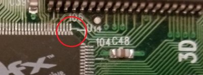

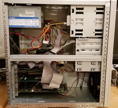

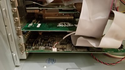

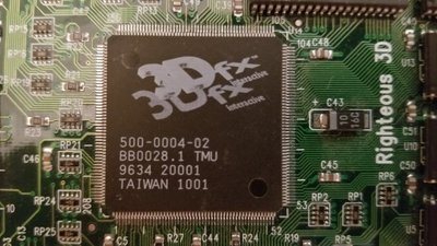

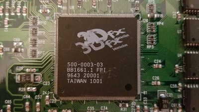

Please post a picture of the card. High res. Very, very often, one of the leads on the main chips will be bent, making contact with another.

Here are the pics:

Reply 15 of 23, by fitzpatr
danijelm wrote:
On second picture on Tmu chip pin 105 is bended. Use knife and bend it back. Its touching pin 106 😉 and try it.
185.42 KiB
3655 views
There she is!
    64.04 KiB
    3655 views
    Bent Pin 105 on Orchid Righteous 3D

Reply 17 of 23, by fitzpatr
tegrady wrote:
Good catch. I will give it a try.
Do you think that could cause the issues I am having?
It is entirely possible that this is the problem, but not guaranteed. No matter what, these leads should not be in contact with each other; hopefully it didn't cause any damage.
It's fairly challenging to get these leads to separate, so use a very thin tool and have a lot of patience.

Reply 18 of 23, by tegrady
fitzpatr wrote:
I'm thinking I will need to use a razor blade and a magnifying glass.
I also found another lead that is touching; you can only see it from the side.
Reply 19 of 23, by danijelm
Its not so hard. I didit lots of times on voodoo cards. And 99% this was the problem. razor blade is perfect for this. You dont need magnifying glass. Put it on light and go.
