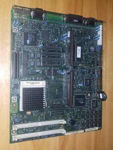

I'm trying my darndest to install cache on my Packard Bell 450 motherboard. I've tried going the 128k and the 512k route.
My jumpers have been in the correct positon, open for none or 128k, and closed for 512k. For the most part when installing the cache, the computer will not post. No booting at all.
Sometimes, it will boot, but whether or not I have "cache enabled" or "cache disabled" in the bios, the info screen during boot will show nothing for L2 cache.
Initially, when I installed the cache chips, the 32k Tag chip (the one on the right) got very hot. So hot that the plastic socket started to melt in the middle.
When I attempted to install the 32k chips in the 4 banks at the left to try a 128k setup, one of the sockets there melted in the middle.
In both instances, there was no further damage to the socket and the chips were able to extracted and reinserted with all points making contact.
Has anyone been successful in putting cache in the PB450 motherboard? Despite the info screen not showing the presence of cache, should I at least reinstall and then run some type of system diagnostic program or speed utility to see if that actually sees the cache installed?

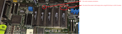

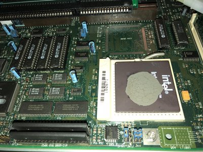

All 4 cache chips (U16, U19, U29, U32), the TAG RAM (U55) and the DB RAM (U57/58) are all installed incorrectly.
Cache (SRAM) came in a DIP-28 package, which means that it has 2 rows of 14 pins, totaling 28. This was fine for 32kx8 bit chips (256 kilobit), but when larger capacities arrived, the package needed to be extended so that all of the data could be addressed. This was extended to 2 rows of 16 pins, or DIP-32. If you're using 128kx8 chips (1024 kilobit), it will take up the entire socket, but if you're using 32kx8 chips, it will need to have 2 rows of pins left empty. The semi-circlular notch in the chip indicates orientation. There will always be some kind of mark on the socket or the PCB silkscreening beneath it to indicate which direction the chip must be inserted.

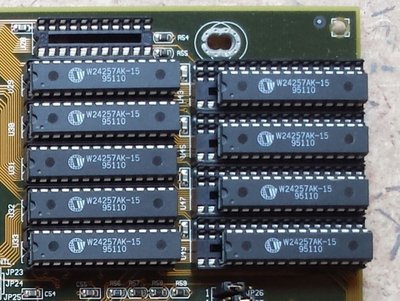

So I'm here trying to find out about cache on this pb450 motherboard I bought on eBay a few years ago. And I'm noticing these melt marks on my cache sockets. I start comparing the manufacturing dates on the chips and then realize I have the exact op board. I guess he sold it when he couldn't figure it out? LoL
    983.76 KiB
    867 views
Reply 8 of 11, by TimWolf
So the W241024AK-20 seems to be hard to locate. However the 15ns and 12ns variants are available. Any downside to using the faster cache? The onboard ram has issues but can be disabled. Could any damage beside the OP cache and melting have occurred from thier backwards cache?
Reply 9 of 11, by rasz_pl
Yes, I would imagine plugging cache backwards might kill it in a way it temporarily passes VCC to all of its pins first, things on a memory bus might not like that. If you are lucky its only ram and not the chipset/cache controller.
