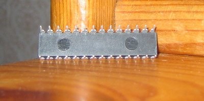

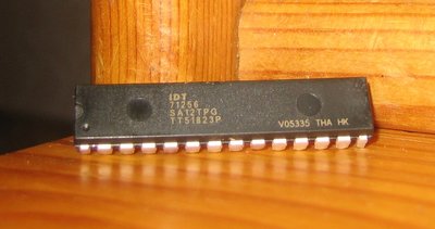

The IDT parts are fakes too - maybe a long time ago there were authentic ones to buy.
Anybody who can buy authentic 12ns srams in SDIP format in 2018... raise your hand. Even some of the ones in SOJ format are chinese fakes.
    123.08 KiB
    1833 views
    65.08 KiB
