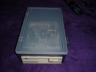

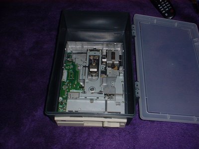

My recently aquired TEAC 5.25 inch floppy is now mounted in a Storage box ..with hopefully enough space for cables ..psu..and the KryoFlux interface I ordered.
Anyhoo ...here is a photo of the drive I will be using ...now mounted in the box.
I will add to this thread when the interface arrives and I have more to post.
In the meantime...if anyone has gone down this route already .
Please Share you experiences ..as this is all new to me.
..and I suspect many other members.
rgds
VS

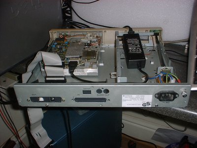

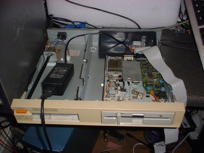

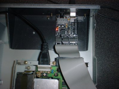

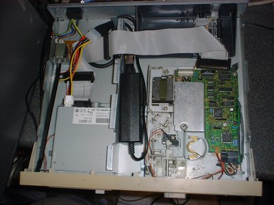

Reply 1 of 6, by Vipersan
So ..scrapped the idea of fiting the 5.25" floppy drive in a plastic box ..but the butchered box came in useful cut up as the mount plane for the Kryo pcb ..which arrived 3 days ago..
I mounted instead inside an old scsi external CD enclosure ...and cut a front space to allow a 3.5" floppy to be mounted as well ..
The Kryoflux board will support a dual drive system ..
So far it appears to work ok with a Panasonic 5.25" floppy drive ..rather well .
In fact dumped my first Comodore 64 game floppy already ..as a test.
I've dedicated an old Optiplex PC running Win7 to the specific task.
It really IS impressive tech ..
I also had to move IDC edge connectors and make a custom ribbon for this build ..
and have yet to mount a suitable 12v/5v smpsu ..
Anyway here are some pics
rgds
VS

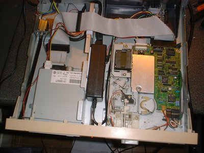

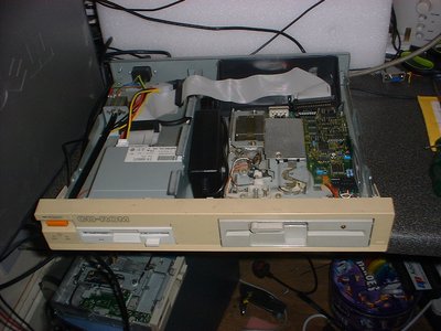

Reply 4 of 6, by Vipersan
Coming together nicely ..
I dont know yet how to use both A and B drives ..Drives 0 & 1
so temporarily disconnected the 5.25" floppy so as to use just the 3.5" ALPS drive ..
Attached is an original Win 95 boot floppy image made with the Kryoflux dual drive ..
and it looks like it will just write to floppy ..though I've not tried that yet..
rgds
VS

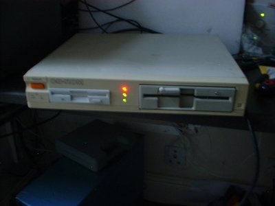

Reply 6 of 6, by Vipersan
Another completed project ..
This unit is soooo coool ..
It can read write dump image just about any format providing the floppy will physically fit in one of the 2 drives..
rgds
VS
