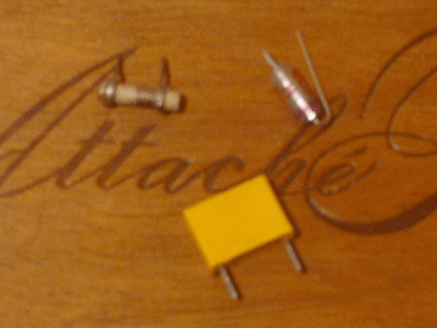

Reply 5 of 13, by Jo22
canthearu wrote:
You can't make a blanket statement on a capacitors state regarding the age of capacitors.
I see plenty of 20 year old or older capacitors that are running just fine.
I second that. As an eletronic hobbyist, I often use old caps -except electrolytics- my father has collected when he was young(er).
To my surprise, the average of them worked just fine in my eletronic projects (I checked them with our LC meter beforehand).
And I'm talking about really old types, such as tubular capacitors and metal foil types from the 1960s/70s.
Same goes for old resistors that predated the colour codes and were human-readable (resistance written in plain text).
That beeing said, I can also understand if someone prefers *new* caps for restoration projects.
