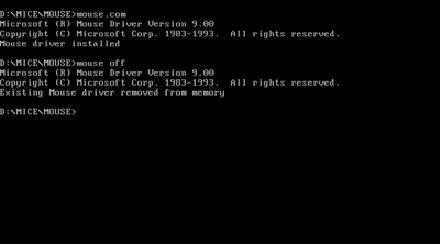

So if you want acceleration off, use:
mouse /P4
  • Protip 1: To unload MOUSE.COM use mouse off

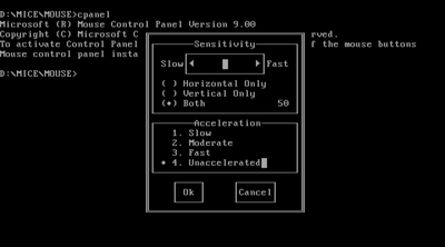

  • Protip 2: Some mouse driver disks came with CPANEL.COM, which opens a small graphical interface that acts like a control panel for DOS mouse. Also, there is usually MOUSE.INI generated at the same place the MOUSE.COM is located

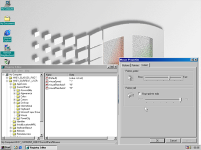

WINDOWS 98 SE (possibly applies to earlier Windows):
Open Registry Editor (regedit.exe)
Open this path: "HKEY_CURRENT_USER\Control Panel\Mouse
Adjust "MouseSpeed", "MouseTreshold1" and "MouseTreshold2"
372.85 KiB
8425 views
Here, this setting will put the slider in 5/7 position. It accepts 0,1 and 2 as far as I can tell. If you want more fine tuning, fiddle with MouseTreshold settings (they accept more numbers, try changing mouse speed in control panel and refresh the registry each time to see what it does):
MouseSpeed=1, MouseThreshold1=0, MouseThreshold2=0
  • Protip 1: If you ever change the setting in mouse control panel, it will overwrite the registry.
  • Protip 2: You can export the registry keys for backup.
  • Protip 3: The settings are applied when you relog or restart. Relogging is the quicker option to get back into Windows and observe your settings.

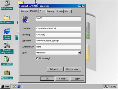

There is one caveat:
Starting a DOS program from Windows (without restarting to DOS), even if mouse registry settings are applied, there will be mouse acceleration.
Workaround:
For MOUSE.COM, it's simple:
  • Run the program from batch file AND/OR shortcut (.pif)
  • In batch, run these:
    mouse.com off (unnecessary?)
    mouse.com /p4
    program.exe
  • In shortcut, in properties, Program tab, in Batch file line add c:\path_to_batch_file\batch.bat, or just c:\path_to_mouse.com\mouse.com /p4

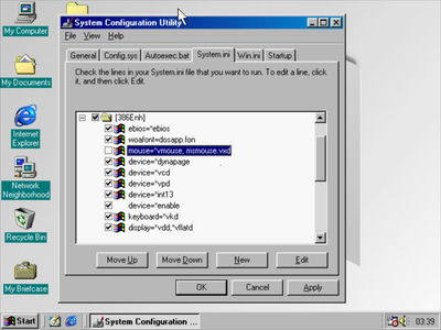

For CTMOUSE.COM, it's less simple, and requires some under the hood stuff and restarting, AND not having the mouse in Windows:
  • Click Start, select Run, type MSCONFIG
  • Navigate to System.ini, find and expand [386Enh]
  • Disable mouse=whatever.vxd
  • Restart, now you have no mouse, but you can use CTMOUSE in the same fashion as MOUSE.COM described above!
  • Just turn on that option back when you're done and restart (maybe even re-log works?) to get the mouse back
