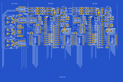

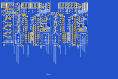

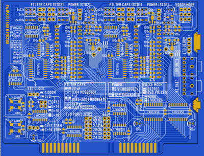

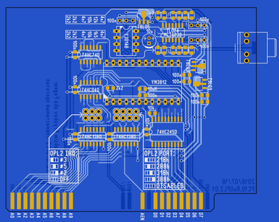

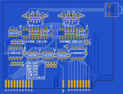

I've started to make single prototypes for each synth to debug each of them one by one on cheaply made boards (squeezing them into 100x100 mm) and I'm slowly composing those blocks into HUGE ISA 8-bit board.
Technologically it will be mostly SMD board (0805 passive, SOT-23 transistors and so on) with minimal TH components (connectors, capacitors) because the board will be big even with SMD.

FMonster

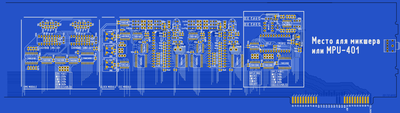

I'm not sure yet will I put OPL2 AND OPL3 on the board, but I probably will, because those are compatible, but sound a little different (also OPL2 in AdLib variant is mono).
I don't know yet if I will put any existing mixer chip (software controlled) or I'll just stick with fixed mix or individual volume trimmers. I didn't research mixer chips yet.
Also I want to incorporate MPU-401 interface into this board with DB-15 connector and WaveTable header, so you can connect external WaveTable synths of your liking to the same board. Probably something like Music Quest PC MIDI (which I've also tried to help reverse engineer).
The name of the project (in the works) is FMonster. F(***)-monster, FM Monster, you know.

As I understand for now, default address for AdLib was 0x388. And for SB16-compatible OPL3 it was 0x220.

Reply 11 of 275, by matze79
What about disabling single card parts ?
Will you add switches add the backpanel ?
Maybe some are conflicting.. tandy 1000 may not work in every PC.
i have tested several systems now, and some will not even boot up to windows 9x with tandy card installed at 0c0h.
But otherwise working fine on MS-DOS.

That is easily accomplished by pulling off jumper that set address for each block. This effectively disables "Chip Select" line of corresonding block. Maybe I'll manage to put them all in a convinient place - it's too early to predict if it would be possible.

Yes, although there is a bit of a 'gray area' there.
The SB Pro 2 and later cards used the OPL3 as OPL2 as well, so the chip was available at both 0x220 and 0x388.
I did some preliminary testing on my SB Pro 2, and my early conclusions were that only the first of the two ports of the OPL3 was exposed to 0x388 (I'd have to test again to make sure though).
However, in DOSBox, the second port was exposed to 0x38A as well.
I suppose this is because certain OPL3 cards also do this. Question is: what do games do?
If there is software that assumes it can run OPL3 from the AdLib address range, then the card should be able to do this as well.
I guess the nicest solution would be a very simple 'switch' to swap the OPL2 for the OPL3 at address 0x388.
This could either be a jumper or a physical switch (at the backplate), or a simple software-controlled switch, so a simple DOS utility could select which mode the card should run in.
This would also allow you to choose between using the real OPL2 for AdLib sound, or using the OPL3 chip in OPL2-compatibility mode.

"Base module" plus "additions" will cost more to produce, it will be harder to manage, connector might play a role in board warping.
Also WaveBlaster header is planned, so DB50XG or SCB-55 could cover up almost half of the board, so "sandwich" design is not a good idea. If "addition" will be plugged in at the end of the board - it will increase its mass and cause even more warping (more so for ISA 8-bit with short connector).
My idea for the moment is: all synth ICs (except OPL3 YMF262-M) will be socketed. So you can leave out some functionality and fill it later if needed. Other parts will be pretty standard and cheap.
For the moment I'll stick with "single long board with sockets" design. Only if it will be impossible to fit in the limits of ISA board - I'll seek out other possibilities.
Today I was working on rerouting some parts to shrink the board's length.
For example, rerouting clock generator module and SSI module I've gained 33 mm of board's length.
81.88 KiB
9250 views
81.95 KiB
9250 views
Work still in progress. CMS part is now the most "long" one, it needs some rerouting too.
