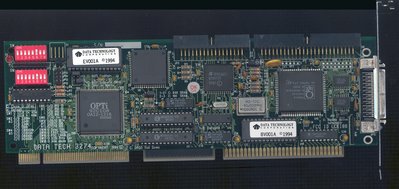

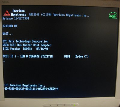

Anyone here have past experience with the DTC 3274 VLB SCSI host adapter card? I bought it about 9 months ago and am finally getting around to testing it. I'm using a PC Chips M912 with Intel DX4-100 in WT mode as my test system, which runs fine using a VLB Trio64 and an ISA Adaptec AHA-1542CP SCSI card.

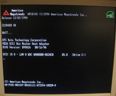

When powering up, the DTC 3274 correctly identifies my HDD, but when I try to boot from the HDD, I get a "Missing operating system" error. I know the HDD is setup properly as a bootable drive because it boots fine with the AHA-1542. I removed the AHA-1542 during testing of the DTC 3274. I feel like I am missing some trivial step. Any ideas?
The DTC 3274 does not have a BIOS that the user can enter prior to boot like Adaptec cards; rather, it is some 18 DIP switches and about a dozen jumpers.

The card contains two SRAM chips, which I confirmed are good using my SRAM tester.
The card defaults SW14 to ON, which is to disable Synchronous Negotiation. I have set this to enabled. This is the only switch I adjusted from the default configuration.

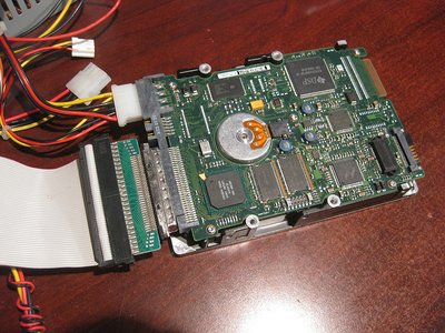

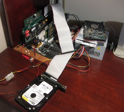

However, I am concerned about the accuracy of the comparison when using a bridge adapter. When I connect my regular 50-pin SCSI drive to the DTC, I get this:
171.53 KiB
948 views
When I attach the IDE drive to the bridge adapter to the DTC, I get this:
194.14 KiB
948 views
With Adaptec adapters, the utilised transfer speed is shown after the HDD's model number. Following the Seagate SCSI drive, it shows 0484. I'm not sure what this is. Perhaps the HDD's firmware? Upon connected the ACARD bridge adapter to the DTC, I get 05.0 and this looks a lot to me like the drive is connected using the asynchronous transfer protocal, which is 5 MB/s. The fast synchronous mode allows for 10 MB/s. I have the DTC's dip switches set for Synchronous negotiation and fast synchronous transfer, so I'm not sure why the ACARD is getting put into async mode. This will invalidate the benchmark results.
The ACARD model is the 7720U, and according to the manual, supports synchronous rates up to 20 MB/s. So... I might need to pilage the 68-pin to 50-pin adapter from my 486 and use an Ultra160 SCSI drive for this test. For whatever reason, I cannot get the 80-pin SCA to 50-pin SCSI narrow adapter to work on these older SCSI controllers. Anyone have experience with these? Looks like this,

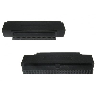

Those cheapo SCA adapters are improperly terminated (they don't terminate the upper bytes) thats why they usually don't work. How do you know the ACARD adapter is only running at 5MB/sec? The SCSI BIOS is almost certainly showing the drive's firmware revision which the ACARD pulls from the ATA ID command. Drive benchmarks should easily get over 5MB/sec from that Western Digital drive, even with the bridge. If unsure, test it with a fast CF card+adapter.

The problem with the SCA to 50-pin adapters is the lack of "upper byte termination" (cheap 68 to 50pin adapters have this problem too). The upper 8-bits of the wide SCSI bus on the drive need to be terminated since they are not connected to anything on a narrow 8-bit controller.

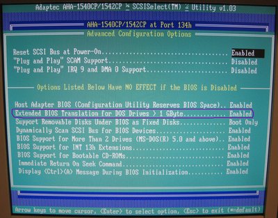

When using the Adaptec SCSI controller w/extended BIOS translation, Dos 6.22 will see 2 GB. When using the DTC SCSI controller with the same HDD, DOS 6.22, that is, FDISK, will see 1 GB. I hypothesise that if I turn off extended BIOS translation on the Adaptec host controller that DOS will also only see 1 GB.
Concerning the SCA, I've given up on it with 50-pin narrow host controllers. They seem to work just fine with Ultra wide controllers. For 50-pin SCSI controllers, I can use the 68-pin version of SCSI drives just fine with passive 50pin-to-68pin adapters.

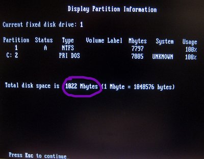

Unknown_K, when using the DTC, FDISK will only see 1022 MB as the size of the entire drive. I haven't yet tried to create multiple 1 GB partitions, but considering it can only see a 30GB drive as 1 GB, I'm guessing that I'd have to add another physical HDD to get more than 1 GB out of this controller. It may very well be that

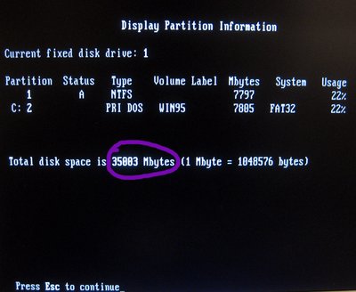

Here is a screenshot of Fdisk when using the DTC 3274VL and a Seagate ST336705LW. Notice it reports the total disk size is 1022 MB. The partitions it is showing on there were created on another computer. I tested fdisk after loading the DTC driver, and when not loading the DTC driver. The result was still 1022 MB. Some kind of SCSI controller limitation?
179.24 KiB
892 views
Here is a screenshot of Fdisk when using the Adaptec AHA-1542CP and a Seagate ST336705LW. It reports 35003 MB, which is the size of the disk.
174.6 KiB
892 views
Here is a screenshot of the Adaptec's BIOS configuration utility. Notice the option for extended BIOS translation for drivers larger than 1 GB. Out of curiosity, I disabled this feature and checked FDISK. I was surprised when it still showed the HDD size of 35003 MB. These results lead me to believe there is some limitation of the DTC which is causing the HDD size limit.
My plan is to benchmark the DTC 3274VL, AHA-1542CP, and the AHA-2842VL using, both, the ST336705LW Ultra160 hard drive and the ACARD 7720U with a Western Digital WD800 Caviar drive. I haven't done a lot of HDD benchmarking. Is there a particular DOS and Win3.11 benchmark for HDD which everyone likes?

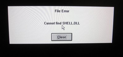

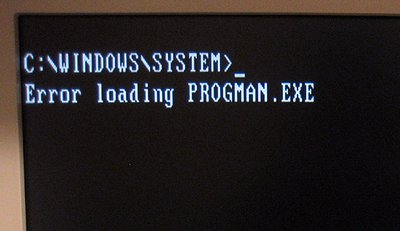

Frustrating. When I try to boot into Win3.11, I get these errors:
55.72 KiB
852 views
112.88 KiB
852 views
Not sure what this is about. I think I'll just bench the SCSI cards in DOS. I want this off my test bed.

VLB DTC 3274VL w/ACARD 7720U + Western Digital WD800 Caviar IDE drive
Random Access Time = 9.7 ms
Buffered Read Speed = 4147 KB/s
Linear Verify Speed = 9261 KB/s
Linear Read Speed = 3121 KB/s
The results are generally unremarkable. VLB SCSI controller with U160 drive is obviously faster than an ISA SCSI card with an ordinary 50-pin narrow drive. Seek time is 2.5x faster for the VLB/U160, as generally could be expected. The transfer rates of the VLB SCSI were about double that with the ISA SCSI. As for the ACARD w/IDE, the seek time is less than the U160, but substantially better than with the ISA+narrow SCSI. The transfer rates with the ACARD were about the same as with the U160 drive on this system. The glaring difference with the ACARD setup is the "Linear Verify Speed", which was 4x greater than with the U160 drive. Why is that?
