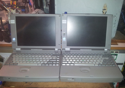

Awesome, i have just been given two of these, well...a 410CDT and 430CDT, both working.
Went to google the specs and good old Vogons pops up!! Soooo...im pretty sure under the circumstances/forum rules i am allowed to necro bump this thread.
Excellent resource info for me...except for the Amsterdam tourist brochure obviously!
First mission priority action will be the removal of any leaking batteries!
Wish me luck! Im going in!!!

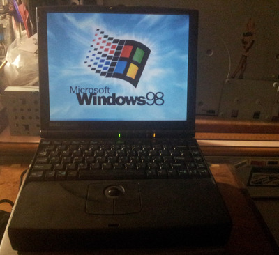

This thing also came with them...but we have no thread here for it yet 🙁
Dell latitude XPi CD P150ST
Reply 12 of 63, by Thermalwrong
All great laptops, the P150ST is something special with its integrated ESS wavetable sound and for its time, excellent speaker quality. It's worth turning off the audio spatialiser in the Windows driver as it seems to cause the audio to go wrong in my experience.
They each need the NIMH batteries removed - the P150ST has the battery just under the keyboard, it can't damage too much and it's not worth taking apart further.
It's great that your 410CDT and 430CDT are working - they're very nice laptops with that impressive 'active matrix' 😀 screen and the solo speaker is impressively loud. Unfortunately, if they're anything like the Satellite laptops I've had from the same era, you will need to remove both the standby battery and CMOS battery ASAP. The standby battery is great at leaking all over the mainboard and the keyboard flex cable, ruining both. Be careful when doing it, I had a 110CT that died on the operating table after cleaning off the battery corrosion 🙁
Hopefully yours were stored in nicer conditions than the ones I've got hold of were, but beware that there can be corrosion on the bottom of the board as well as the top.
Reply 13 of 63, by bandicoot67
Thank you for the tips kind sir! I am on the case. Was looking around the web kinda hoping someone had already done a detailed repair breakdown of the old Dell like this cool thread for the 430CDT but, it looks like i may have to be the first to document the whole operation!
I guess if it helps the next human who finds a Dell P150ST, and they should happen to end up on Vogons looking for possible answers, then that's we are all here for right!
