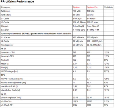

but i will never understand whats the deal with this pentium pro era to build a retro gaming PC, because the cpu is supposed to be really bad for 16bit WIn3.11 and Win95 &98.
The CPU is not "really bad for 16bit". I use it mainly with mid-90s DOS games and early Windows games together with a Voodoo 3 2000 PCI.
This is a comparison that the German IT magazine c't made in issue #1 of 1996 between a Pentium 133 and a PentiumPro 150:
37.9 KiB
665 views
Pentium 133 vs. PentiumPro 150
As you can see the 16bit Performance is not too bad... 😉

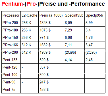

The PPro also had a 2nd level cache (on a separate die in the same package) that was running at CPU clock (200MHz) and not at FSB clock (66MHz) like the Pentiums at the time. This made him very expensive (prices from December 1995):
15.06 KiB
665 views
CPU Prices December 1995
It was also the time when I got my first job after university. I could only dream of a PC with a PPro then. Now after the vintage computing wave got me, the first thing I wanted to have was a PPro. And I'm all happy with it.
