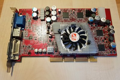

Sapphire Atlantis Radeon 9800 Pro 128M AGP ATI Radeon 9800 Pro

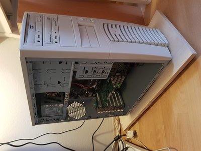

Reply 1 of 22, by arncht
feb 2018

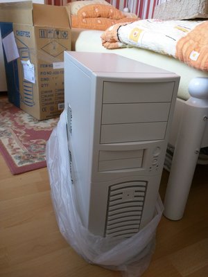

Chieftec Dragon DG-01W
originally i have bought it for my pentium iii project, but this is the real period for this case.

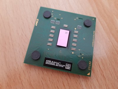

AMD Athlon XP 3200+
the top cpu from amd, before the athlon 64 release.

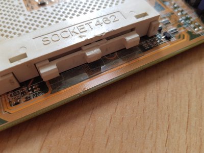

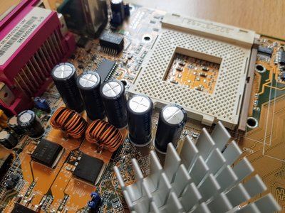

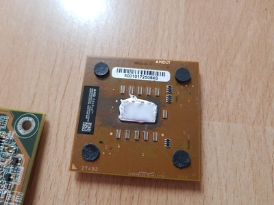

Reply 2 of 22, by arncht
aug 2018
most of the mainboards of this age has problems with capacitors. very common problem, it is hard to find something in an "original" condition, i dont want it to recap.
i found an asus a7n8x deluxe 2.0, the caps are in quite good condition. anyway very bad experience. burned cpu, damaged socket, and pcb. i could boot just once (with another cpu), then i gave up.

Reply 6 of 22, by canthearu
If you want an athlon xp system, probably a good idea to get used to the idea of recapping stuff. Very few boards will still have the original capacitors in good condition. Even the photo above of yours shows at least one capacitor bulged and that would have a negative effect on the motherboard working properly.
Also, don't forget you need a power supply with a strong 5V rail, as the vast majority of Athlon XP motherboards did not have the 12V aux power feed.

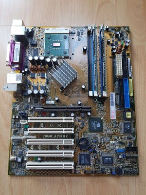

Reply 8 of 22, by arncht
sep 2018
Asus A7N8X Deluxe rev 2.0 NVIDIA nForce2 Ultra 400
second round - it is a very nice condition board, but the caps are also not perfect. anyway the memtest86 looks ok - i will run more torture tests.
it comes with every accessories, which is really nice, but i don't plan to use them (com, firewire, joystick port etc).

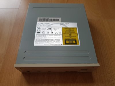

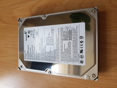

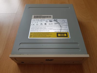

Reply 9 of 22, by arncht
sep 2018
Seagate Barracuda 7200.7 120G IDE
LiteOn XJ-HD166S 16x DVD-ROM IDE
LiteOn LTR-52327S 52x32x52x CD-RW IDE
authentic drives - the liteons beige is a little bit different, but this is the original color, no discoloration.
the 120g 7200.7 not a special drive, but actually does the job - and this is the most silent hdd from this age without any vibration.

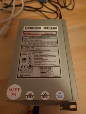

Enermax EG365AX-VE(G)
with powerful 5v, fits to the top end socket 462 config.

Reply 11 of 22, by arncht
ATI Radeon 9800 Pro
595.7 KiB
3134 views
1.89 MiB
3134 views

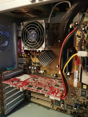

Reply 15 of 22, by arncht
if it is slow something, i use the newer retro pc 😀 i have 5 pcs from 1994 to 2006.
basically i want to fly back to the past with the period correct pcs to relive a the age. they are authentic from the sw, os, drv side too - like a time capsule.
Overdoze of the demoscene

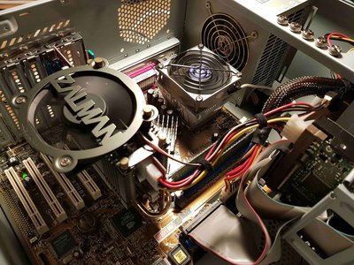

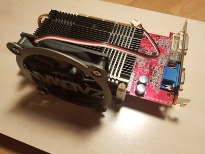

Reply 16 of 22, by arncht
more silent radeon 9800 pro (zalman zm80c-hp + op1 - released around Jun 2003).
    1.3 MiB
    2587 views
Reply 17 of 22, by arncht
fck... the card with the zalman is dead, just the red agp led is lighting. anyway, i replaced the cooler on my original card. i used a 12-5v adaptor, the zalman is not too silent.
    579.48 KiB
    2493 views
Reply 18 of 22, by Xplo
Nice build and project log! Enjoyed the read.
Did you have the modify the zalman zm80c to get the OP1 fan to fit? Lots of resources online suggest the OP1 is only compatible with the zm80d (which is pretty much the same as the C, but has blue heatsinks and dual heatpipe)
