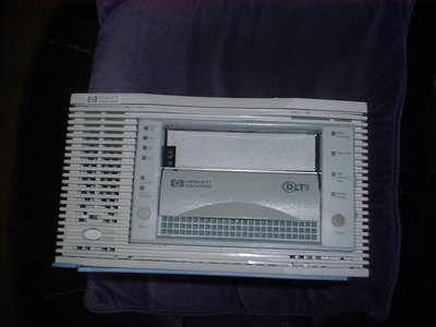

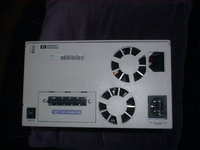

As promised ..a couple of photos of this HP DLT ..
cannot find a model number ..
I guess it is DLT5 ?
not sure which tape cart is supported ..
No idea what the rear connector is ..though obviously a wide scsi variation.

Reply 6 of 22, by derSammler
That's LVD SCSI (low-voltage differential). You need a corresponding SCSI controller for that. Don't try to connect it to an ordinary ("high-voltage") SCSI controller, as it will cause damage to the device and/or the controller.
Internally, however, that drive probably uses normal Fast Wide SCSI. The LVD interface seems to be on a swappable module. I know quite a few HP DLT drives, but I can't recognize that one. It must be one of the earlier ones, as later ones had DLT followed by a number.

Reply 17 of 22, by eisapc
The drive pictured is ment to be used in a special HP SCSI enclosure, got some SCSI DVD drives having the same strange connector.
Therefore it features this blue eject lever on the bottom of the drive.
http://www.ebay.com/itm/HP-C4317A-RACK-MOUNT- … 5-/272409890168
If you want to use the drive without purchasing the enclosure, best is to swap it to a different case or connect a short ribbon cable to the usual internal wide SCSI connector.
The drive looks like a 35/70 GB DLT 4 drive.
Some good info on DLT drives was at http://www.useddlt.com, but it seemes to be taken over.
