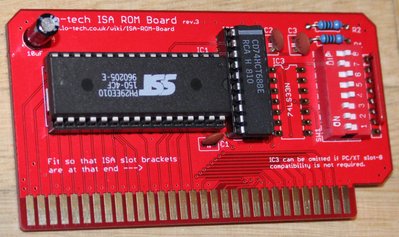

This is my board after assembling:
747.13 KiB
1386 views
Problem: Regardless of the DIP setting, the ROM appears in a 32 kb window at E800:0 or also C800:0.... 🙁
I have the following differences to the Rev. 3 bill of materials that can potentially cause this issue:
1) SN74F521N instead 74HCT688N: are exactly the same, e.g. according to
http://www.ti.com/lit/ds/sdas228a/sdas228a.pdf
"′ALS688 Are Identical to ′ALS521"
Therefore it should work?
2) 74LS33N missing:
Only needed for XT-slot-8
3) 7-pin instead of 8-pin resistor network:
The "empty" Pin 8 is connected to DIP-1 which switches the XT-slot-8 on and off. When the DIP is "off", there is no connection to anything else. Therefore this shoulnt be an issue?
4) Resistor network itself:
A "10k Bussed Resistor Network - Bournes 4608X-101-103LF" is required:
https://www.mouser.de/datasheet/2/54/600x-776645.pdf
I checked with a spare of my 7-Pin:
- There is 10k between Pin1 and each of the other 6 Pins
- There is 20k between the other Pins, e.g. Pin 5 vs. Pin 6
--> this should be the correct one
5) I use the board with a SST-PH29EE010 instead of SST39SF010A. Both have same capacity and pinout. I am programming it in my TL866 and it can be read as SST39SF010A in the TL866. It is also read in the Lo-Tech board, but at the wrong adress as mentioned above. Theerfore this is also no problem?
Also re-checked all solder-points, seem to be OK.
I also assumed the SN74F521N is damaged. Unfortunately the 521/688 are not supported by the TL866 for Logic-IC test. I have in total 5 of the SN74F521N and also tested another one, but its the same...
Anybody have an idea where to start..?
Thank you!

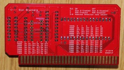

Nothing to hide on the backside: But I have to admit, some points look "weaker" on the photo than with my eyes:
457.57 KiB
1330 views
I also came to the conclusion that the only possibility is the comparator. As written, I already tested another from the same lot. In the meantime ordered a new CD74HCT688E...I hope this will be the solution.
Reply 4 of 26, by matze79
I also would solder the "weaker spots" again.
Reply 5 of 26, by keropi
yep use a little more solder on the weak spots just in case
Reply 6 of 26, by root42
Seconded and thirded. I see a lot of empty spots on the populated pads. I think you are a little low on the solder for those.
YouTube and Bonus
Reply 7 of 26, by gdjacobs
Many of the joints do look a little dry, although none look over filled or blobby. Just ensure everything has proper fillets, then clean that flux off.

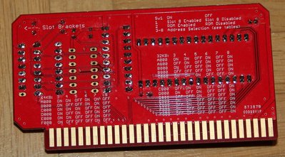

So I put some more solder on all points...:
1.09 MiB
1266 views
Indeed, something has changed: Now I see 64k at E000:0, but still no change when switching the DIPs. So this was only part of the problem...

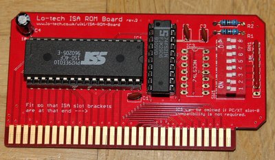

CD74HCT688E arrived. Still the same. ROM is at E000 all the time.
Flux doesnt matter at the moment and contacts are clean. Also tried different slots...
Reply 12 of 26, by keropi
ca you check with a multimeter the socket pins in case one next to the other makes contact?
Reply 15 of 26, by Predator99
Last hope was to assemble another board...did this and use another EEPROM - AT29C020 this time.
It exactly the same. DIP settings dont matter, ROM is at E000.
At the moment I conclude that these PCBs have an issue....
