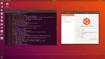

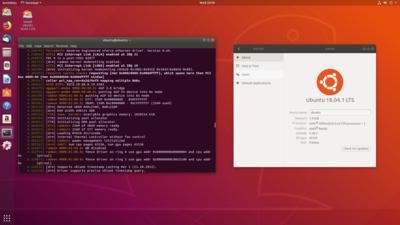

First of all, I can confirm the board will definitely work in AGP 8X mode with Windows XP SP3 32-bit with a dual core CPU. However, you have to install a "special" nVidia All-In-One driver from Asrock's site. It's basically the latest nForce 3 driver (5.11) with a slightly older GART driver version.
Secondly, I can also confirm ATI GPUs work normally under Ubuntu 18.04.1 LTS 64-bit (using the agpgart-amd64 driver). This means the chipset can indeed work with multi-core CPUs and AGP 8X using a 64-bit OS. I can't believe nVidia couldn't release a working driver, yet open source engineers were able to do it without access to full documentation. See it with your own eyes (running with the HD 3450):

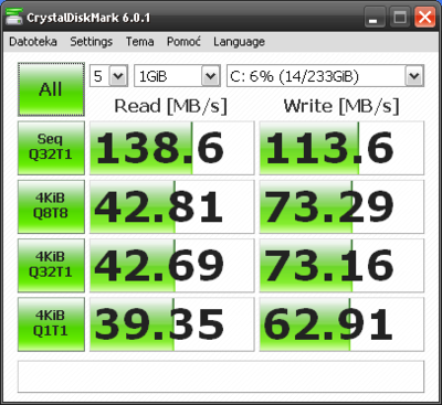

The board only has 2 SATA ports and they are SATA I. However, the system is still very fast with an SSD (the Windows XP loading "snake" will only go about half a bar before it's done).

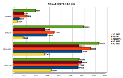

Finally, onto the performance.
42.64 KiB
4545 views
You can see the full gallery here: https://imgur.com/a/MDhjcgb
Here are a few observations:
- 3DMark 2000 is CPU limited to 28k-29k; in comparison, my Pentium 3.0 GHz Prescott is limited to around 11.8k, which would indicate a roughly 2.5x increase in performance
- 3DMark 2001 result is kind of bad with HD 3850, I expected above 40k given the relatively high CPU clock speed (it's barely faster than X1950 Pro)
- 3DMark03 and 06 results are very good in my opinion, they could probably go 10% higher with a faster CPU (Phenom) or faster RAM
- the HD4650 is a 1 GB DDR2 version and it sucks due to memory bandwidth (it's about on par with X800 XT)
For testing, I used 2 GB of Kingmax DDR2-800 with 6-6-6-18 timings (because I'm short on DDR2, I even had to steal this from another PC).
The memory defaults to 533 MHz for some reason, but manually setting it to 800 MHz works perfectly and uses timings from SPD. The board supposedly works even with DDR2-1066, but I don't have any such modules.
The only other setting I changed is setting the AGP aperture size to 256 MB (default is 128 MB) because I read about issues with too low AGP aperture on similar nForce 3 boards.

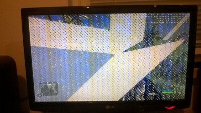

Unfortunately, there was a casualty during testing. After finishing all the benchmarks, I fired up Crysis on the X1950 Pro. I first started the game at 1024x768 to check CPU performance and everything was working fine. A few seconds after switching to 1080p it crapped out.
1.31 MiB
4545 views
I'm not sure if it's a core or memory issue (looks like core because triangles were flying all over the screen, but it might be VRAM because of the familiar pattern). These situations make me seriously reconsider the hobby of collecting old crap that has the potential to die any minute. It was the nice 512 MB Sapphire version too...

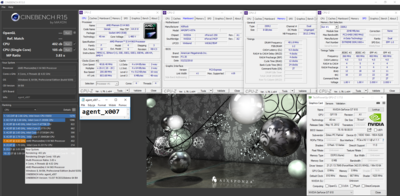

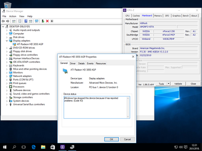

Anyway, I decided to install Windows 10 x64 v1511 on a spare HDD. Here it is, the infamous Code 43:
159.43 KiB
4457 views
Windows Update was able to find the driver and it install it, only to disable the card afterwards. You are stuck on 1024x768 resolution.

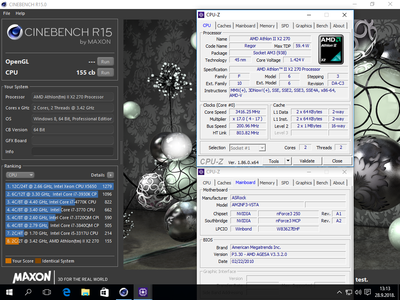

Here's my Cinebench score:
502.5 KiB
4457 views
I think we can conclude this problem was indeed never fixed.
Therefore, I cannot recommend this board as an alternative to Asrock 4CoreDual-VSTA/SATA2, Conroe865PE, Asus P5PE-VM or other similar boards.
Considering Steam support for XP will be dropped on January 1st 2019 (and with Firefox support already being dropped), platform longevity is a serious issue.
To sum up:
- you can run the board with any CPU and any GPU without any problems on Windows XP 32-bit until the end of time
- you can run newer versions of Windows with a PCI graphics card (obviously too slow for any kind of gaming)
- it's supposedly possible to run Nvidia AGP cards in PCI mode on newer operating systems, but I didn't test this (once again, too slow)
- you will NOT be able to install drivers for any ATI card on operating systems newer than XP if you're using a multi-core CPU
- if you have a single core CPU, everything should work perfectly on any OS (but it defeats the purpose); I didn't test this because I didn't find an option to disable a core in BIOS
- if you want a modern 64-bit OS, you will have to use a Linux distribution; everything works out of the box, but you are limited to the open source Radeon driver which is slower than Catalyst
Please correct me if I made any mistakes.
Yes, pretty modern hardware is too hot to live long life 😢
That's it for now. I will probably be trying out Windows 7 SP1 in the future just to confirm the GART driver issue. If that fails, I'll try Windows 8.1, and finally Windows 10 version 1511 (last one with AGP support).
I had artifacts similar to these with a 1900XT 256Mb, only they very purple, but then the game was Company of Heroes mostly. In my case I think it was the vrm section, the pcb all turned crimson and bent inwards.

Hey, someone of you here know how can I install the Windows XP on SSD that I have just bought if this motherboard don't support AHCI mode?
I have only RAID or NON RAID option in the bios.
How can I do now? It's impossibile to have AHCI on this NF3 chipset motherboard?
Computer lover since 1992.
Love retro-computing, retro-gaming, high-end systems and all about computer-tech.
Love beer, too.
Reply 18 of 30, by agent_x007
NF3 doesn't support AHCI (IDE mode only if non-RAID is selected).
Use [RAID] option, and either integrate it's driver to XP install (pre-done ISOs are also fine) or use floppy with "F6" option.
