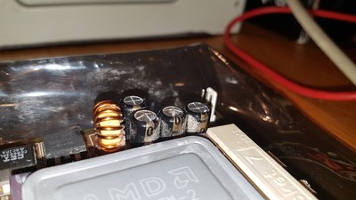

Reply 4 of 24, by Baoran
I was thinking of replacing with the same type of electrolytic capacitors because I don't know enough about capacitors to know what kind of different type of capacitors would work. There are also 1000µF 6.3V capacitors next to the cpu socket that are bad and I was thinking of replacing those with 1000µF 16V capacitors.

Reply 12 of 24, by root42
Two of those caps look extremely bulging. Also yes to the fact to go with the samw or similar ESR rating.

Reply 14 of 24, by TheMobRules
Just get some good (Japanese) low ESR 1000uf 6.3V or 1000uf 10V and call it a day, those are extremely common values in Socket 7/Super 7 motherboards. No need to worry about different voltage or capacitance, it won't be of any advantage unless you're trying to fit them in cramped spaces where the usual sizes may be too large. Be sure to replace all of those, if a couple are bulging I'd say the other ones near them are probably also about to croak.
Using caps with too low ESR *may* be a problem but in my experience those S7 motherboards are pretty tolerant in that sense.
If you also want to replace the smaller ones just go for same capacitance and same (or higher) voltage and make sure they are of a Japanese brand and rated up to 105C.
