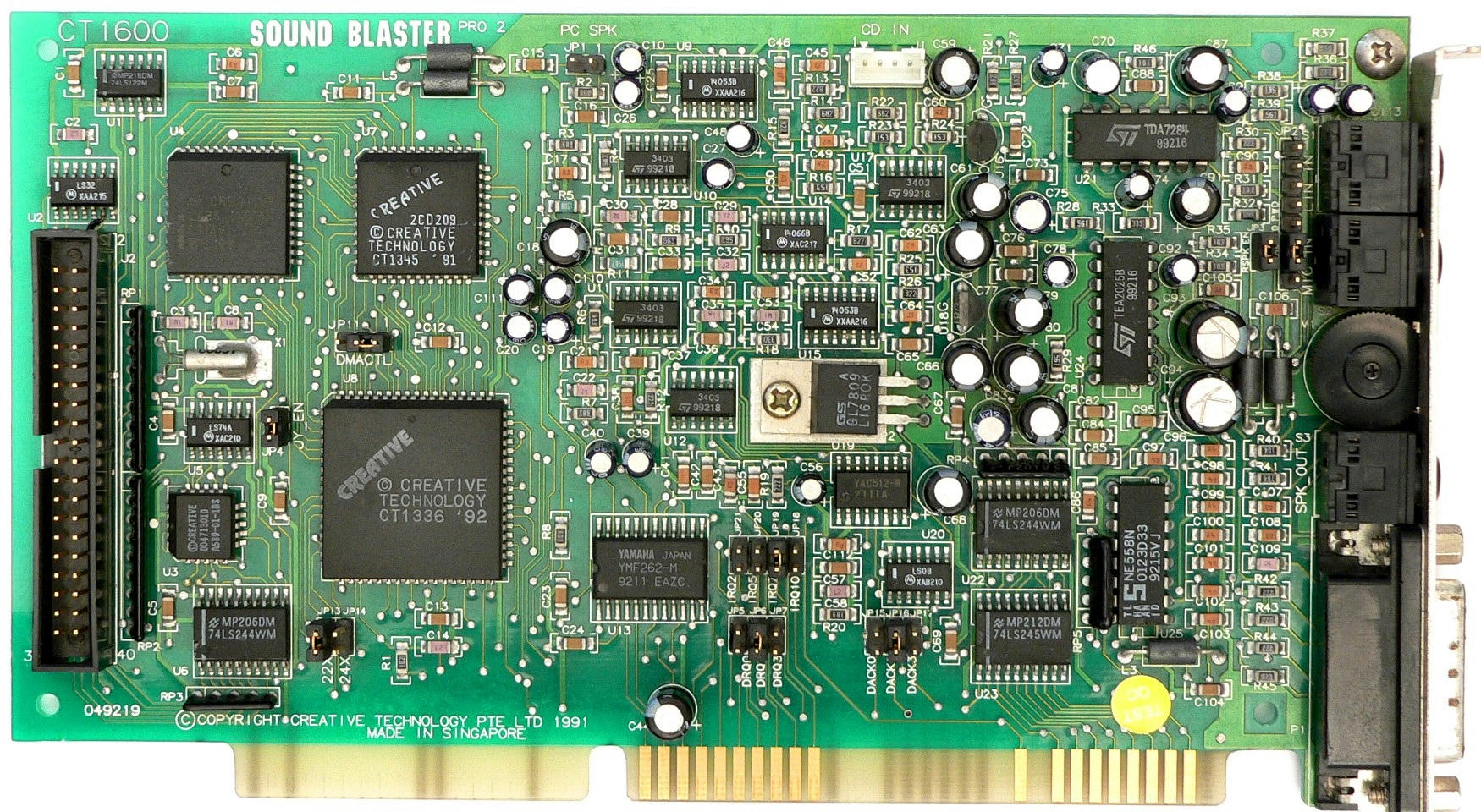

Reply 6 of 21, by Baoran
cyclone3d wrote:
What revision is your CT1600?
If I remember correctly, there was some discussion a while ago about how maybe the earlier revisions had speed issues while the later ones did not.
I actually don't know. I have not seen any revision markings on the card.
1.89 MiB
1228 views
Reply 7 of 21, by fitzpatr
The bottom left number "059234" is the revision information. In this case, it is Revision "05", which was designed in year 19"92", Week "34"
I did have issues with my CT1600, same revision, in a K6-3+ 450. I had to slow it down to about 200MHz for it to run properly in all cases.

Reply 9 of 21, by Scali
This is a later model CT1600.
The earlier ones have a copyright date of 1991, and they do not have their own crystal. They take the clock from the 14.318 MHz NTSC signal from the ISA bus.
This is an earlier one (like the one I have):
4qwdgeqjuummj35zg.jpg?size_id=a
