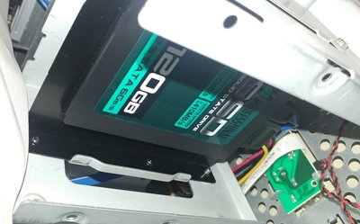

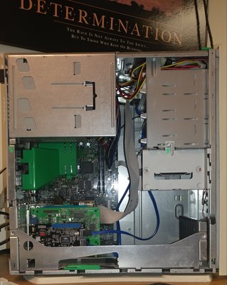

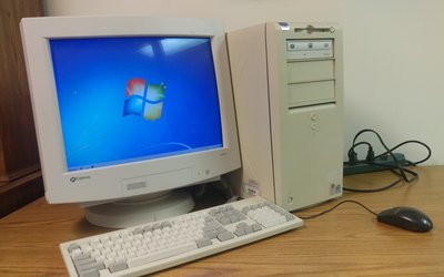

Because why not? I was off from work with nothing to do all day so I went over to Microcenter on the other side of Philly and picked myself up the cheapest SSD and a PCI SATA card. The process means having to install Windows XP and then launching setup from XP with the Windows 7 DVD. It didn't even take that long, I was expecting more lengthy install times but maybe the SSD helped with that. It it surprisingly usable everything considered (so long as it isn't graphically demanding) and I took it on-line briefly with a bridged connection from my laptop to check for driver updates. Was using the no SSE version of the backported New Moon (née Palemoon) for browsing which it does alright but multiple tabs start to bog it down. Have all of the operating system effects save for text smoothing shut off and the color knocked down to 16 bit. Managed to strip the home premium HP OEM key from my broken college laptop and use phone activation to make it official. Even tried a little cable management. And look at that outstanding windows experience index!

Specs: Dell Optiplex GX110
-Pentium 3 933MHz
-512MB PC100 ram
-16MB TNT2 graphics (its the only PCI I've got)
-120GB Inland Professional SSD (microcenter house brand?)
-SYBA SATA controller

Reply 1 of 14, by appiah4
That poster in the background is incredibly fitting for this build's photo.

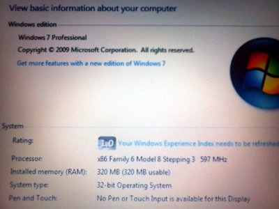

Reply 2 of 14, by gca
Not as silly as you might think. I have had Win7 running on an IBM X20. As you can see from the (very poor, sorry) image attached it is even more underpowered than the GX110.
I didn't do this on purpose though. I simply swapped the drive from another machine and missed the prompt to select the boot device. Surprised it didn't BSOD immediately.

Reply 7 of 14, by detritus olentus
I've never done it before, did I do it right?
https://www.3dmark.com/pcm7/1168987

Reply 11 of 14, by Errius
I've never seen that before on PCMark 7. I have seen it happen on PCMark Vantage on certain hardware setups. I don't know if it's a bug or just does this by default on under-specced systems.
