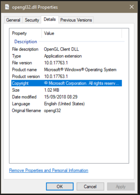

M$ are indeed the authors of the default openGL32.dll in Windows\System32
15.72 KiB
2621 views
Now what happens when instantiated ... well ... what do we reckon?

Reply 6 of 19, by Scali
I suppose you are not familiar with what ICD is: Installable Client Driver.
See here: https://docs.microsoft.com/en-us/windows-hard … e-client-driver
The default OpenGL32.dll runtime is indeed written by Microsoft, and it acts as a sort of 'proxy'. Applications are linked to this opengl32.dll, and this DLL will scan through the registry for ICDs, and forward the calls to a compatible driver (you'll find that the actual OpenGL driver for your graphics card is not usually called opengl32.dll at all).
Direct3D works in a similar way. It's the only way to be able to support multiple devices in a single system, and to allow the user to choose which device to use in an application. Or even use multiple devices in a single application.
