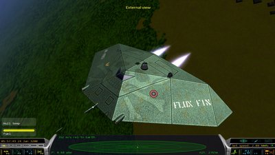

OFF TOPIC (or not as)!
The attachment screenshot-20190125-031331.jpg is no longer available
Could it be closer?
Yes it's simple because it's simply the exact geometry of FE2 and it's made "simple" in the manner of v0 = v(1,0,0) v2 = v(-1,0,0) v3 = v(0,0,0) draw triangle v1,v2,v3. project on texture coordinates so and so and use this material.
