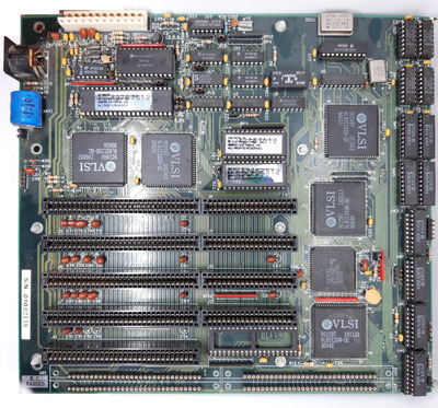

The motherboard is this:
I've looking for in the typical websites and I haven't found nothing about that mobo. I would like to upgrade the memory. It has 512kb of memory.

Before doing anything else you shoudl remove the battery 😉
Maybe you are able to upgrade to 640k by adding an identical chip to the empty socket on the bottom left.
But you should be able to add an additional 4MB with 4 SIPP-modules. Maybe there is a jumper to switch between banks, just try all of them 😉

I second the battery removal. Also, good chance that it will auto detect the RAM in the SIPP sockets. Stason TULARC didn‘t have this specific board either, I think. Any markings or stickers on the back?

I think you only need to add 1 single chip to get 1 MB. The empty small sockets on the bottom right are parity I guess.

Think my proposal to add the 8. chip is the most cost effective solution to get more RAM. Dont see the kind of the chips on the photo, but 4 of these are 512kb (which are detected) and the other 3 are currently unsused.

I've token some pictures more closely of the chips: all chips are equals: mb81c4256-80p
I understand the motherboard has 512kb in a bank and 384 Kb in another bank. 512 kb is running but the other 384 kb is deactivated. If I buy a mb81c4256-80p and it plugs in the socket in the left botton corner and I modify the jumpers it should be 1mb the ram. is it right?

Yes. You dont need exactly the mb81c4256-80p, there are many compatible ones...google. Dont think you have to modify jumpers for this upgrade.

The Chips were received a few days ago. I tested yesterday... and YES I plugged one chip in the empty socket and I get 1024 KB of memory .
