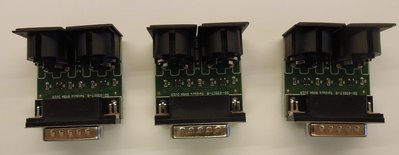

Hi,

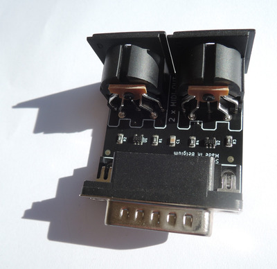

as I ran out of Joystick-MIDI cables, and promised a friend to make a solution for him.
I had this small run (12pcs) of DB15MIDI PCB's produced.
It is a simple PCB that allows to connect 2 MIDI modules to your DB15 joystick port.
Connectors :
- DB15 (Joystick MIDI)
- 2 x DIN connector (MIDI OUT)
190.26 KiB
1633 views
204.71 KiB
1633 views
It works well for my setup, but I'd love some more feedback :
- does it work fine for you ?
- is the form factor OK ?
- does it need a 3d printed enclosure ?
So I am giving 8 of these away with purchase of any product from my webshop.
Contact me through PM or through https://www.serdashop.com/Contact in advance, if you are interested.
Thanks for your support !

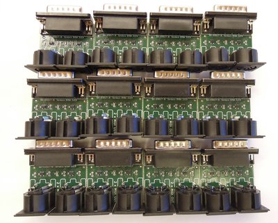

Reply 1 of 11, by dreamblaster
here's the complete batch 😀

Reply 2 of 11, by matze79
It works really well i also got one from Dreamblaster and connected the Buran Module to my Gameport!
Thanks for another nice piece of Retro Hardware!
Reply 3 of 11, by LunarG
Not sure about the form factor, and yes, it needs an enclosure of some kind. I think turning it into a "all in the cable" device instead of a box type device would probably be more usable, at least for me personally it would. Perhaps it's a girly thing, but I'm not that fond of exposed PCBs on the outside of the computer case.

Reply 5 of 11, by Tiido
Would it fit in the bottommost slots ? I think the PCB will touch the metal edge on the bottom in most computer cases.
I imagine a version in a DB15 shell with 2x MIDI cables coming out to be more useful, you could probably just cut an existing MIDI cable in half and connect to a PCB in the shell. Should result in a pretty ok solution, similar to the LPT devices.

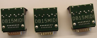

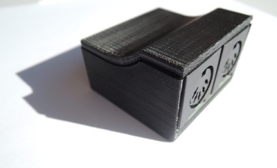

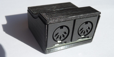

Reply 7 of 11, by dreamblaster
Finally found the time to try out the 3d print enclosure design by kaide79 :
it looks and feels great --> see photos
STL files available here : https://www.thingiverse.com/thing:4602088?fbc … 5tdEKcCT_mFpzE4
I will also add this cover as option on the webshop - https://www.serdashop.com/DB15MIDI

Reply 8 of 11, by mkarcher
Tiido wrote on 2019-02-07, 09:22:
There is the option to use a non-angled 15-pin DB15 connector, and solder the PCB between the two rows of the pins. That should enable the adapter to be pluggable in any slot. The big DIN-5 connectors still would collide with a plug on a neighbouring card. One could produce the board in two orientations, so that the DIN-5 plugs block either the card above or the card below the sound card. I don't expect differentiating this product into two variants is economically viable though.

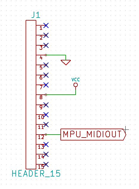

Reply 9 of 11, by oskarzer0
I am a happy owner of a "DB15 to 2 x MIDI out adapter". I need to connect it to a mini-DB15 laptop connector with dupont cables, because I don't have the original cable.
Could you tell me the minimum number of pins that I need to use, please?
Thanks!

Very few !
only ground, vcc and midi out signal :
see screenshot

Reply 11 of 11, by oskarzer0
dreamblaster wrote on 2022-11-04, 20:31:
Very few ! only ground, vcc and midi out signal : see screenshot DB15PINS_DB15MIDI.png […]
oskarzer0 wrote on 2022-09-20, 23:20:
Thanks!
Very few !
see screenshot
Perfect! Thanks a lot!
